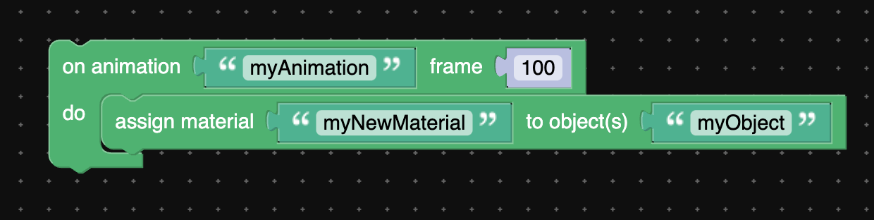

    you could just use two nested puzzles:
    on animation “MyAnimation” frame “the end frame”
    do
    assign material MyNewMaterial to object(s) “myObjects”

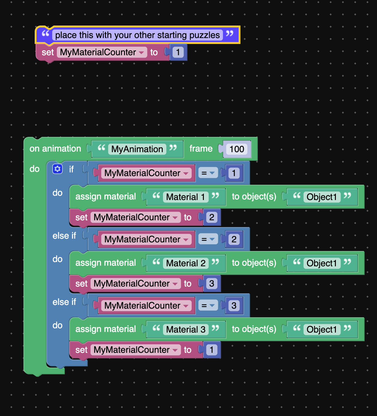

    You can add an if else loop. Be sure to add global variable to initialize it.
    the other puzzles would be placed after the play animation puzzle.

    Hey thanks. I got it to work:-)
