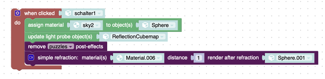

2023-11-03 at 10:20 am #68187kdv
ParticipantPlace a cube reflection probe at the center of your sphere and update it after changing textures.

2023-11-03 at 4:44 pm #68194alissa
ParticipantI included the puzzle “remove puzzles post-effects” and now it’s working.

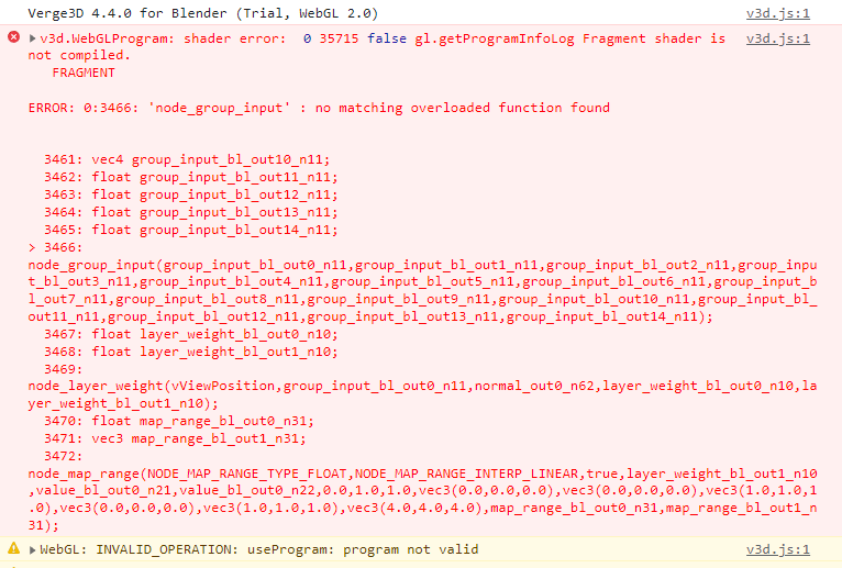

ParticipantI took a look at your scene and see that the environment is correctly refracted (all three variants). Also I see that the SSR pass is not active and I don’t see how to activate it.
And you managed to create a buggy shader in your 3D editor.
