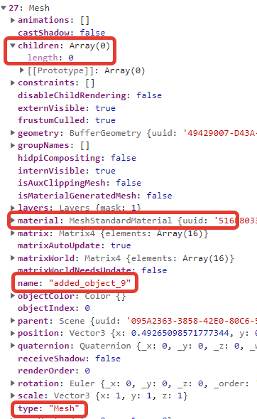

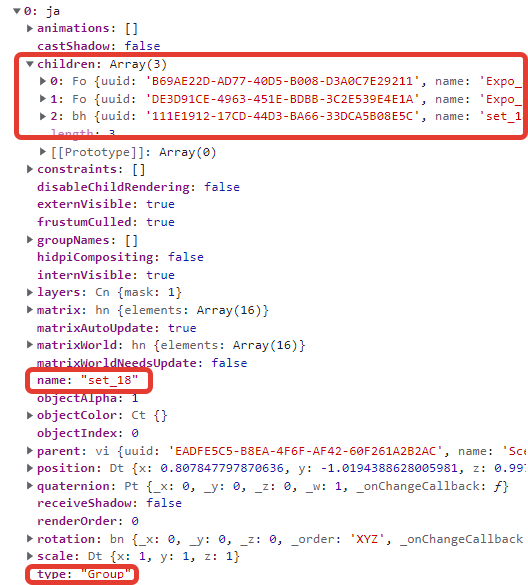

    No, there is no such a puzzle. Objects are selected by their names. Parts of a single-material object have no names.
    A single-material mesh
    A multi-material mesh
