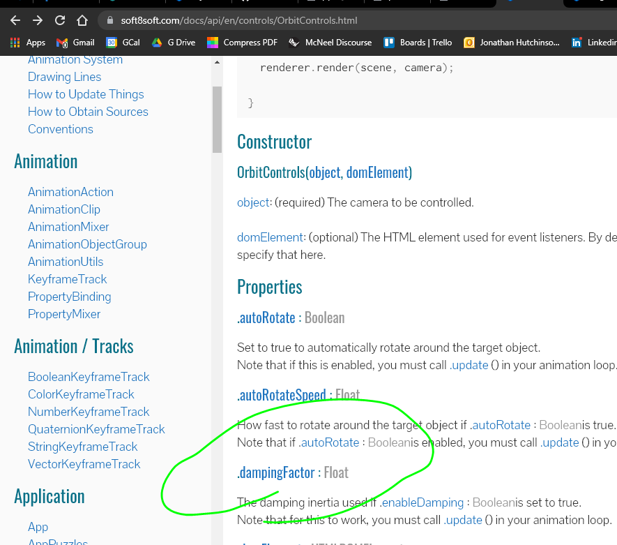

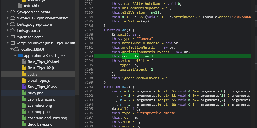

jdhutchinsonCustomerHi Ivan,
Thank you for the response. I got this working on the basic cube example from the documentation, thank you.
See attached image. How can I tap into the v3d elements through an exec js script puzzle? Or is my attachment oversimplifying this?

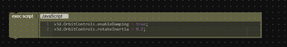

Also tried (in an exec script puzzle):
app.camera.enableDamping = true;
app.camera.rotateInertia = 0.2;Attachments:

Ivan LyubovnikovStaffSee attached image. How can I tap into the v3d elements through an exec js script puzzle? Or is my attachment oversimplifying this?
You can do that through
v3d, for example,v3d.Meshorv3d.Scene, but it’s usually for when you need to create new objects before adding them into the application.In order to change something that’s already there you can use the
appvariable. For example, the controls are available asapp.controlsand the scene isapp.scene. So, dumping can be modified like this:app.controls.rotateInertia = 0.2;Co-founder and lead developer at Soft8Soft.

I guess something that I would find useful to know, is what variables has verge3d already created during initialisation, in other words which objects can I scrutinise and set properties/use methods of. In this case, under the hood, my application has kindly created the necessary variable for an EnableControls object, named controls.
I’m still a little confused though why the v3d documentation mentions dampingFactor though: https://www.soft8soft.com/docs/api/en/controls/OrbitControls.html#dampingFactor

jdhutchinsonCustomerI’m not sure.Still confused by the API terms in the documentation not being right.
