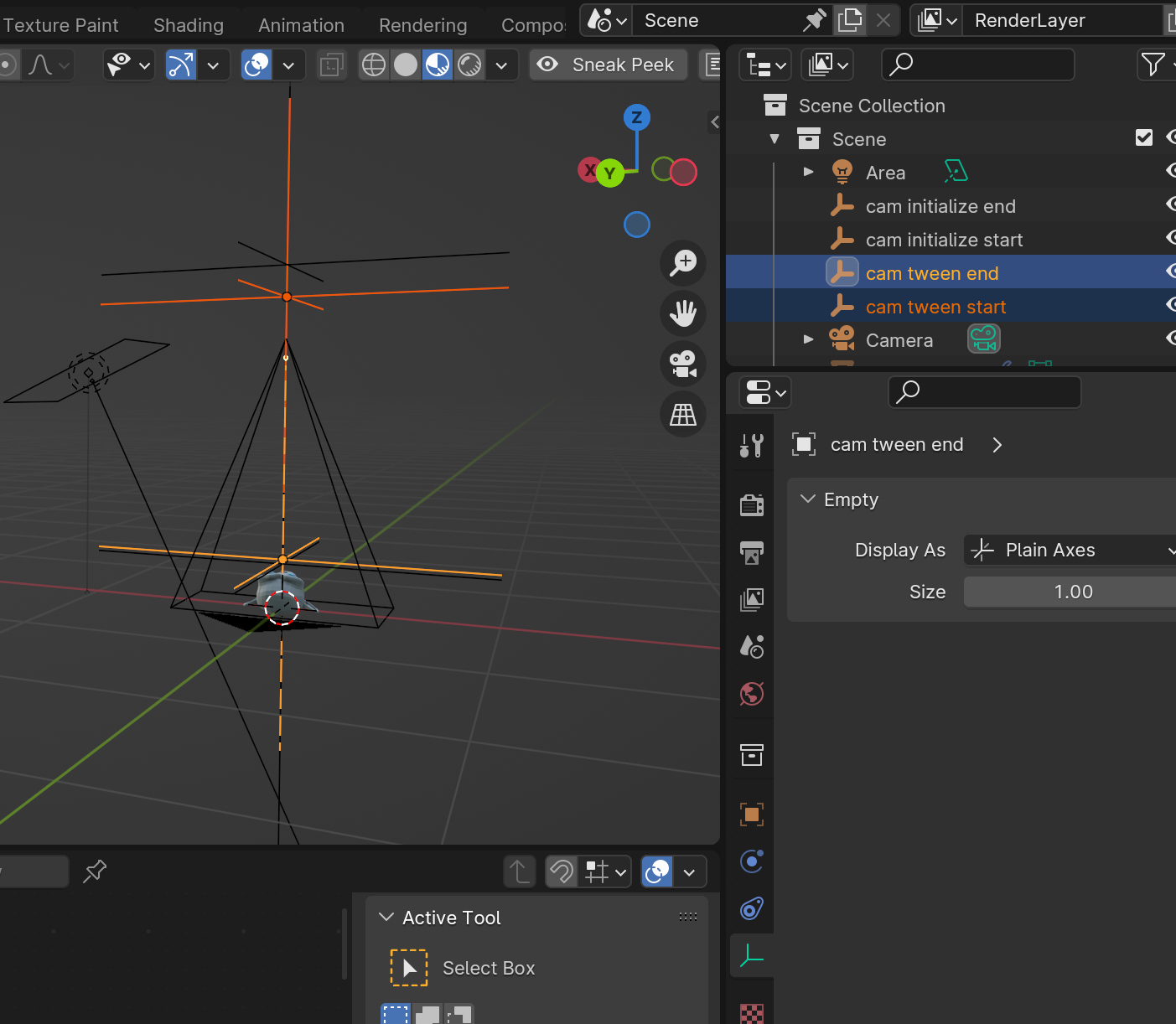

Also here is a screenshot of the puzzles.

I have also included a screenshot of the blender scene.Attachments:

xeonCustomerIt appears you have four camera location empties.
This is what I believe is happening.You start your scene at camera_initialize_start and looking at camera_initialize end.
For the sake of simplicity I am going to assign the z values to explain whats happening. They do not match what you have going on precisely.
Camera_initialize start is at z=5
Camera_initialize end is at z=.2
This sets the initial position of the camera and has a time value of 0.When the user clicks on the eyes
The camera Jumps to (because the tween time is 0),
The camera moves from Camera initialize start to camera_tween_start.
Camera_tween_start is further away from the monkey…so we will say Z=6
The camera target changes too … its now camera_tween_end and its located closer to the monkey…lets just say z=.1So you moved the camera further away from the monkey… the camera is moving backwards.
You also moved the target closer to the monkey which also adds to the effect of the camera moving backwards.If you want the camera to move forward…. move the camera_tween_start somewhere closer to the monkey.
Recommendation: You named your initial empties correctly. But your other names may make the understanding of how this works more difficult.
You may want to rename Camera Tween Start to Camera Tween End. Its the location where the camera will end up when the tween is completed. You can leave the When clicked Tween camera look at to be the same as the initial Camera_initialize_end.
But again the naming is odd.
I would suggest renaming your emtpies:
Camera_initialize_start. >>> Camera_Start_Location
Camera_initialize_end >>> Camera Start_LookAt
Camera_Tween_Start >>> Camera_Tween_Location
Camera_Tween_End >>> Camera_Tween_LookAtIn the tween puzzle…the first object is the “position of” you want the camera to move to. The second position is the look at. This is where the camera is pointed to. The tween puzzle moves the camera from its current position to the position specified in the “position of” within the tween puzzle.

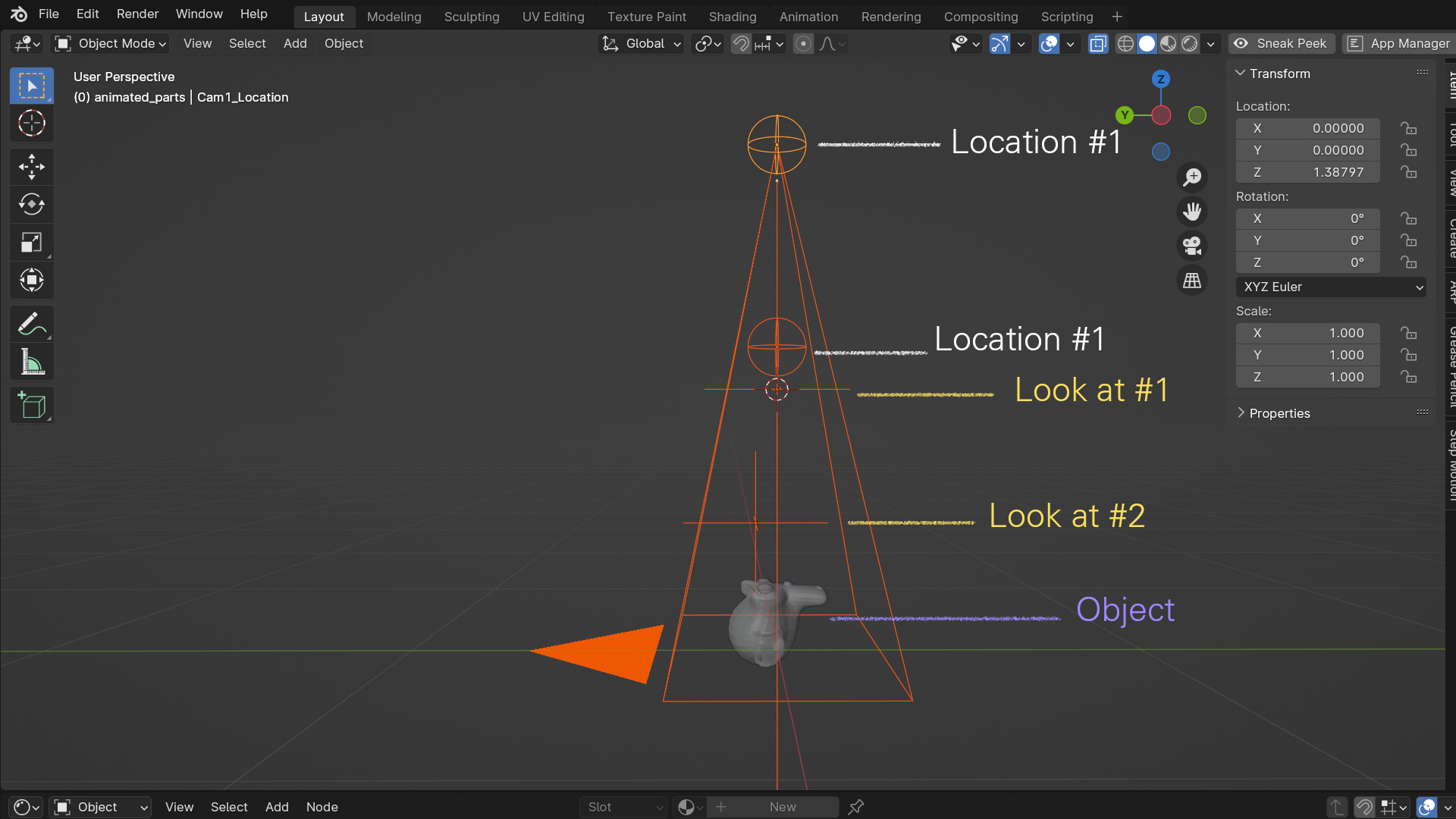

ParticipantUnfortunately it is not running perfectly. When empties are aligned on z axis (x and y have default values) it works as you have described but when I move the second (even a little bit) ‘look at’ empty on x and y axis OR the location empty then it rotates on z-axis? I have looked at the ‘global illumination’ project and I don’t see the issue there even when I change the empties around. What I want should be (theoretically) simple: first we see the whole object as wide shot. Then zoom in on a piece of the object, centered in frame (so the camera has to move on x-y axis).

ParticipantKind of. Before we click anything the object is positioned as expected. But if I want to focus in on object, let’s say upper right corner, the camera rotates on the z-axis. For example if you move this empty ‘CAM_Target_2’ more to the upper right corner for: x-axis = 0.7 m, y-axis = 0.7 m and z-axis = 5.07679 m (value stays the same), you’ll see that the camera rotates.

xeonCustomerI believe and someone with a deeper knowledge of why V3D does this on the Z-axis can chime in. I have not found a good for solution for this other than not have my camera tweening from in a dominant Z axis. It works fine any other axis.
You can do other things to avoid using the tween such as camera zoom or you can animate you camera in Blender and just animate the camera for that sequence. You can use puzzles to move it too but tween…not great in Z.
