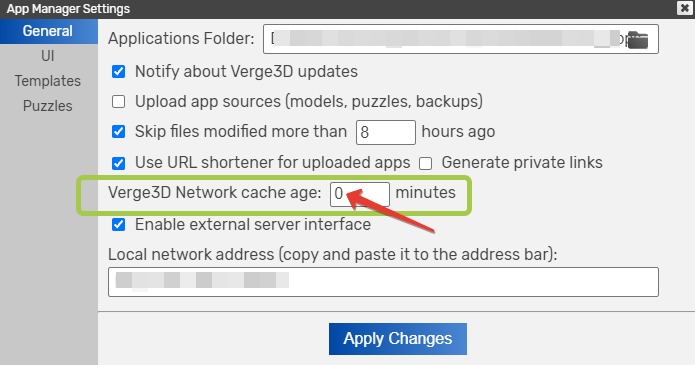

2024-12-14 at 8:55 am #79390kdv
ParticipantBut the problem remains that the scene (or at least parts of it, i cant tell for sure) does not refresh
2024-12-14 at 9:54 am #79393
justin_blenderCustomerI never knew this setting.
Actually i am using my own host, not the v3d network.
But could it be the setting “skip files modified more than 8 hours ago” then?2024-12-14 at 10:21 am #79396kdv
ParticipantActually i am using my own host, not the v3d network.
then it depends on your host’s cache settings…
no. that option is for uploading only. it allows to ignores old unchanged files when re-uploading.
