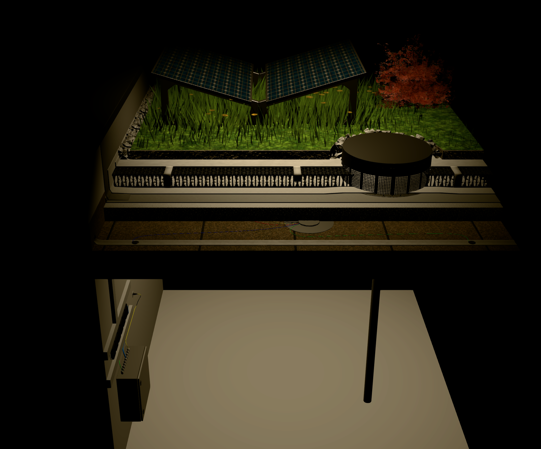

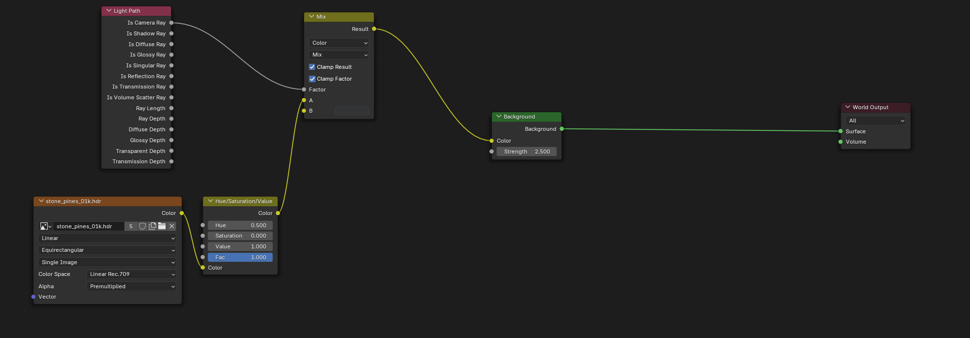

    Hy,
    we encounter some issue after switching from blender 4.3 to 4.5.2 and verge 4.08 to 4.10
    The backgroundshader was working fine before.
    Is there some change to verge or blender according lightpath node?
    Thanks for any hints.
    Phil

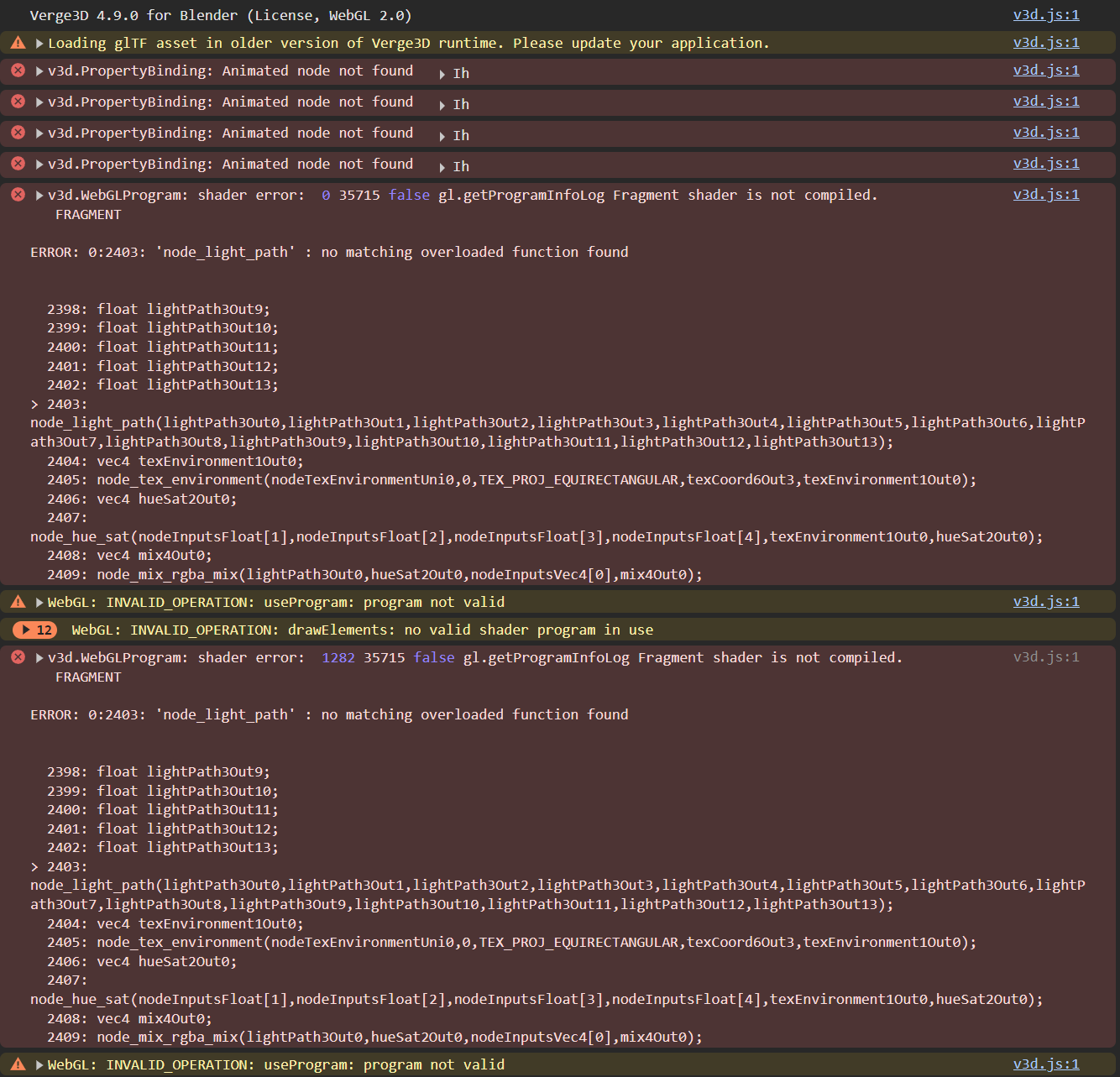

    #84643
    in Blender they added one more option. 14 arguments instead of 13. and it looks like you didn’t update v3d.js for your app…
    #84646
    It appears your app is not updated (shows 4.9.0 in the browser console which is not compatible with recent Blender versions). Hence the message “Loading glTF asset in older version of Verge3D runtime”.
    Please update your app as shown in this guide.

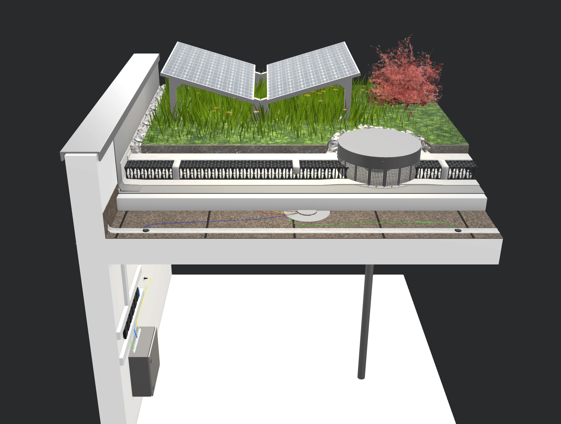

    #84669
    Philipp
    Hey @all
    thanks for give me the hint with updating the app!
    works like a charm!
    greets phil
