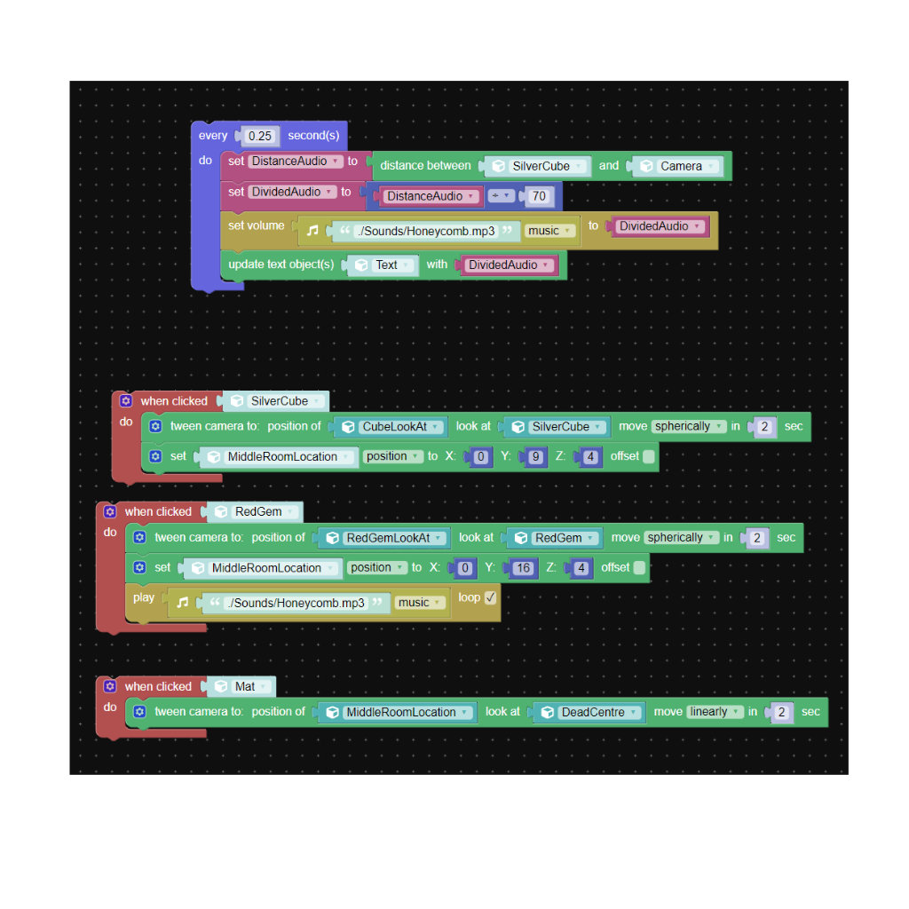

    Hi All,
    I am currently testing Verge4 for an audio focused WebGL project. I got a form of simple proximity based audio working and was quite pleased with the result.
    It works fine on Windows (Edge and Chrome) and Android but the volume does not seem to have any effect on mobile Safari and just plays at full volume.
    Is it likely to be an error with my puzzle or an iOS limitation?
    Many thanks in advance.

    #53435
    say “thanks” to Apple )))
    https://stackoverflow.com/questions/19502696/setmuted-or-setvolume-do-not-work-on-ipad-in-mediaelement-js
    On iOS devices, the audio level is always under the user’s physical control. The volume property is not settable in JavaScript. Reading the volume property always returns 1
