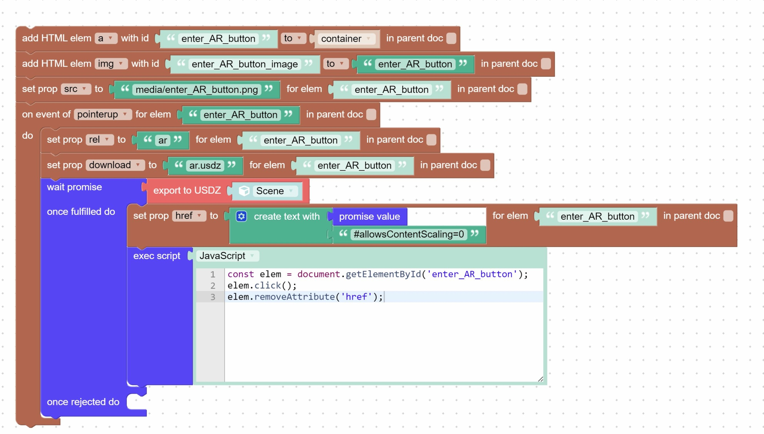

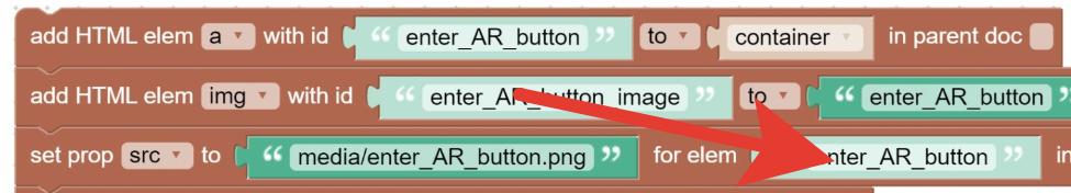

    Mmm… why did you change <img> id to enter_AR_button??? Do you understand what is id? <a> should have id enter_AR_button, <img> should have id enter_AR_button_image
    #57226
    Gabriel Malzer
    I changed it. but still don’t see the AR button. see new puzzle and web.
    #57228
    one more change
    #57230
    Gabriel Malzer
    The AR button is here. super. The AR mode starts.

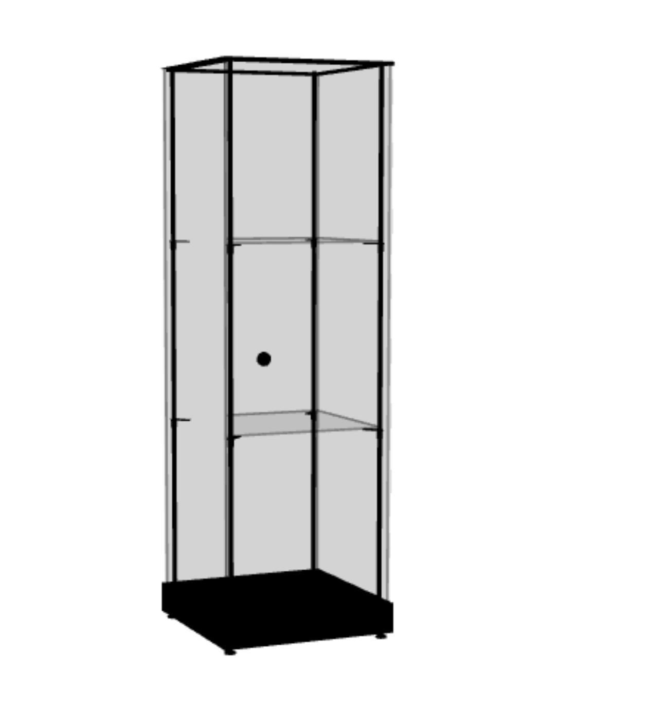

    For me, however, only the wheel comes. I don’t see a model? Why is this?
    #57231
    Because no meshes were exported. The USDZ exporter understands only gltf 2.0 compatible material (MeshStandardMaterial). MeshNodeMaterial is not supported.

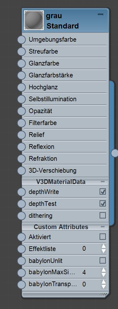

    Gabriel Malzer
    I have 3D Max 2020 I can only select Depth Write, Depth Test and Dithering here under Verge 3D Data. I don’t see GLTF 2.0.

    #57240
    https://www.soft8soft.com/docs/manual/en/max/GLTF-Materials.html
    https://www.soft8soft.com/topic/4-1-1-verge3ds-ar-does-not-work-with-ios-16/#post-55995

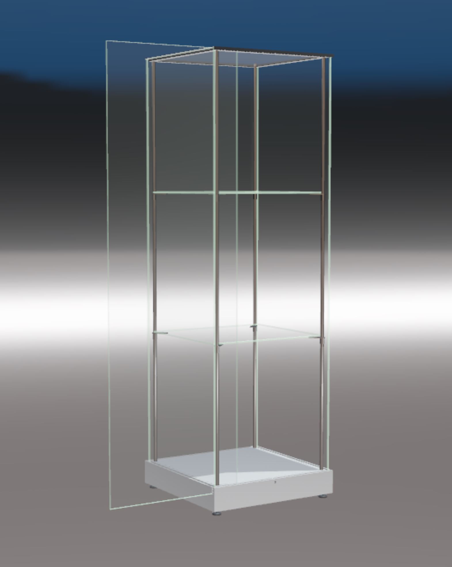

    Gabriel Malzer

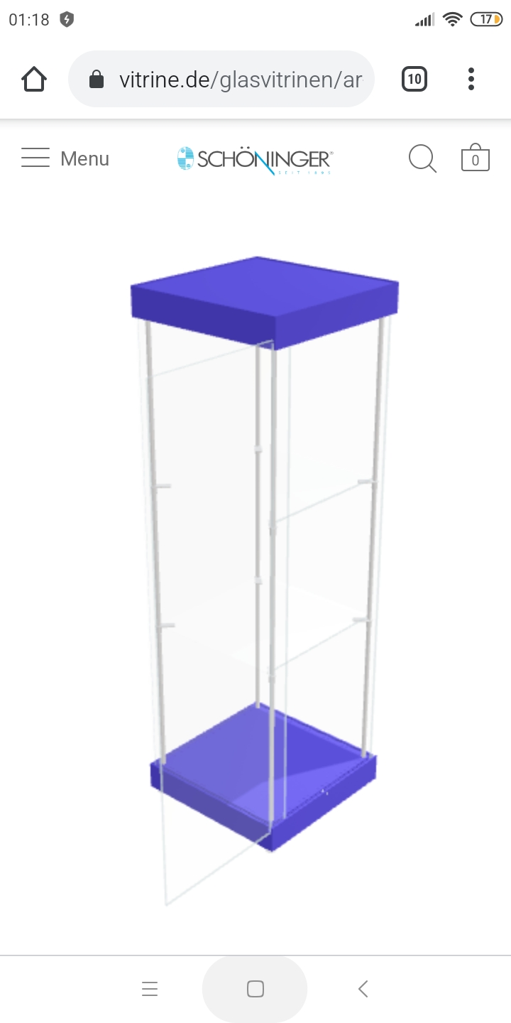

    The app works great…. now I am facing my older problem that when I make in 3d Max sneak peak picture1.jpg is displayed. If I export the scene and open it with Verge App then my scene looks like picture2.jpg. I do not understand why this is the case.
    I have a spot light in the scene.

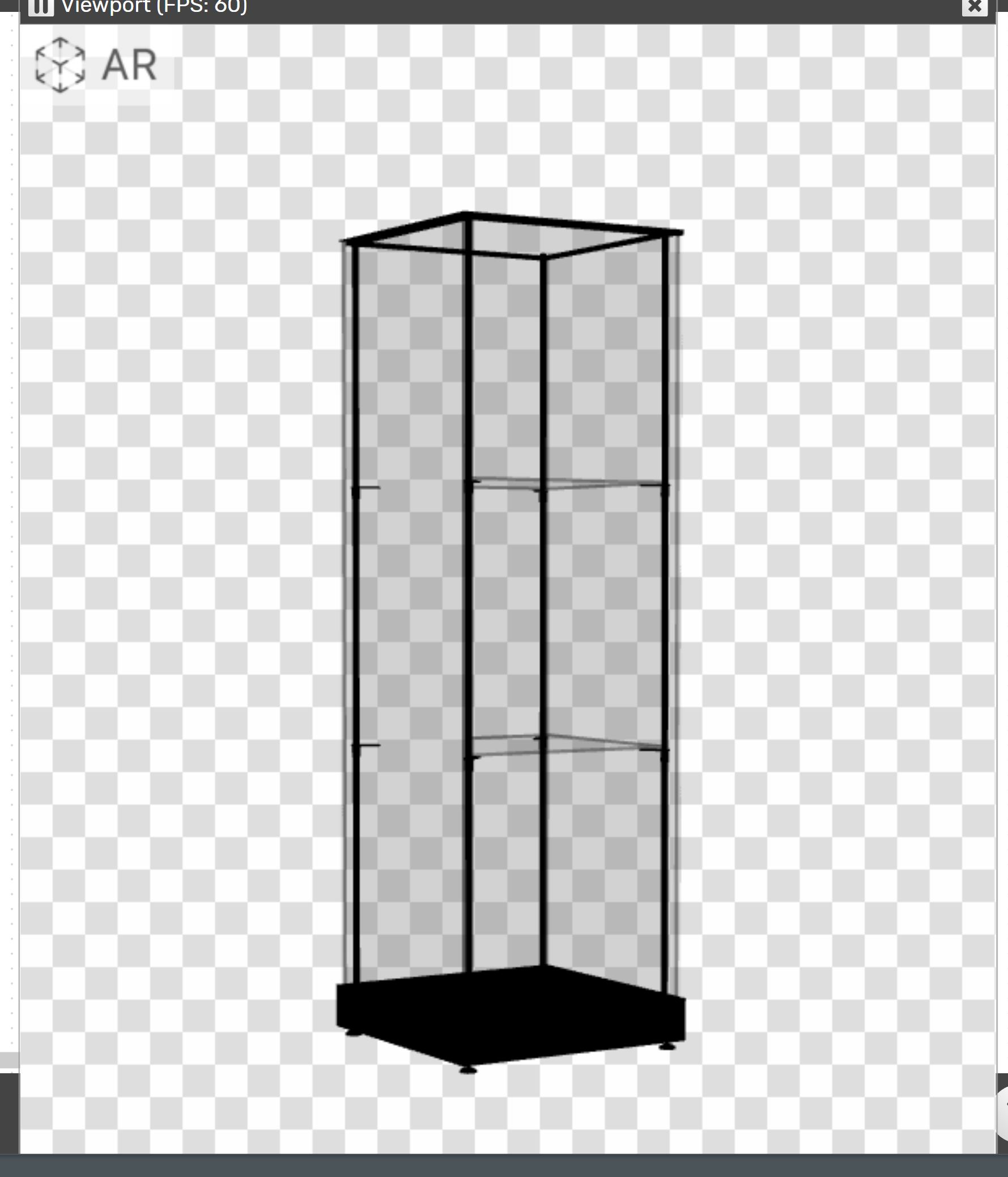

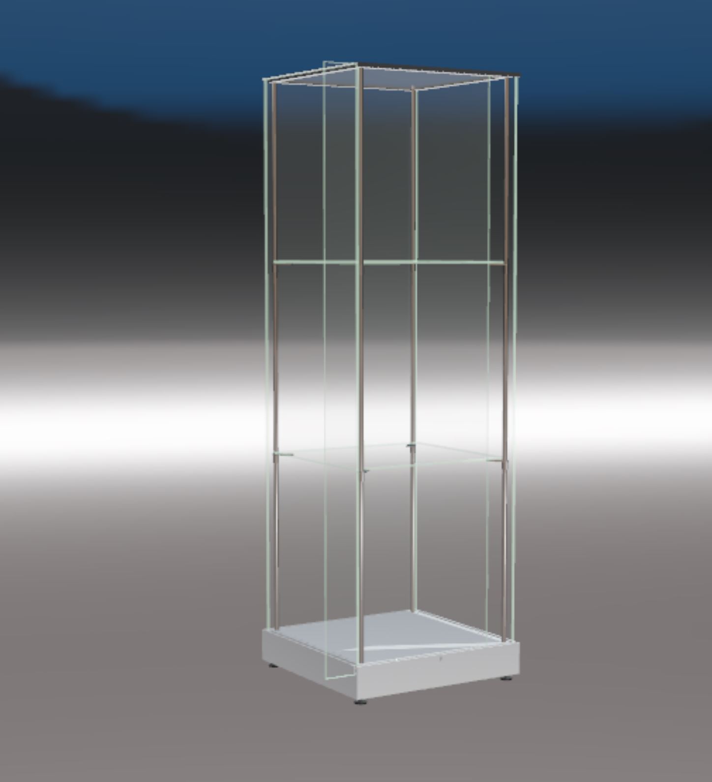

    #57326
    Gabriel Malzer
    when I insert the create environment puzzle I have my materials. However, then I miss the transparent background, as well as all limitations of zoom and rotation for the scene. If I do sneak peak in 3dMaX everything is ok. Why is this?
    #57327
    Gabriel Malzer
    https://vitrine.de/glasvitrinen/museumsvitrine-saturn/
    This is the link from the app. Here with the enviroment puzzle
    #57328
    Gabriel Malzer
    the pictures from 3d max sneak peak and from verge 3d without scene puzzle.
    #57332
    Use this trick: load an empty scene with light and camera only, nothing else. The scene must be exported as usual, without any glTF 2.0 compatible limitations, just as you did it earlier. Then append you model with glTF 2.0 materials to this scene.
