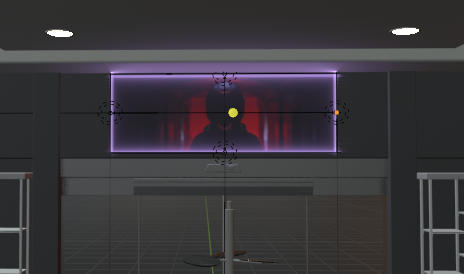

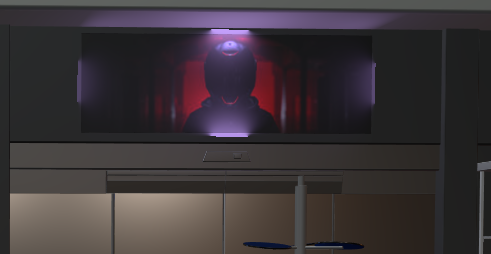

    lamthanhle
    hi Alex,
    Area light work not correct.
    (v3d 3.6 pre1)
    #36651
    Seems like you scaled area lights, better to use Size x,y in area light preferences to get proper size instead of scaling.

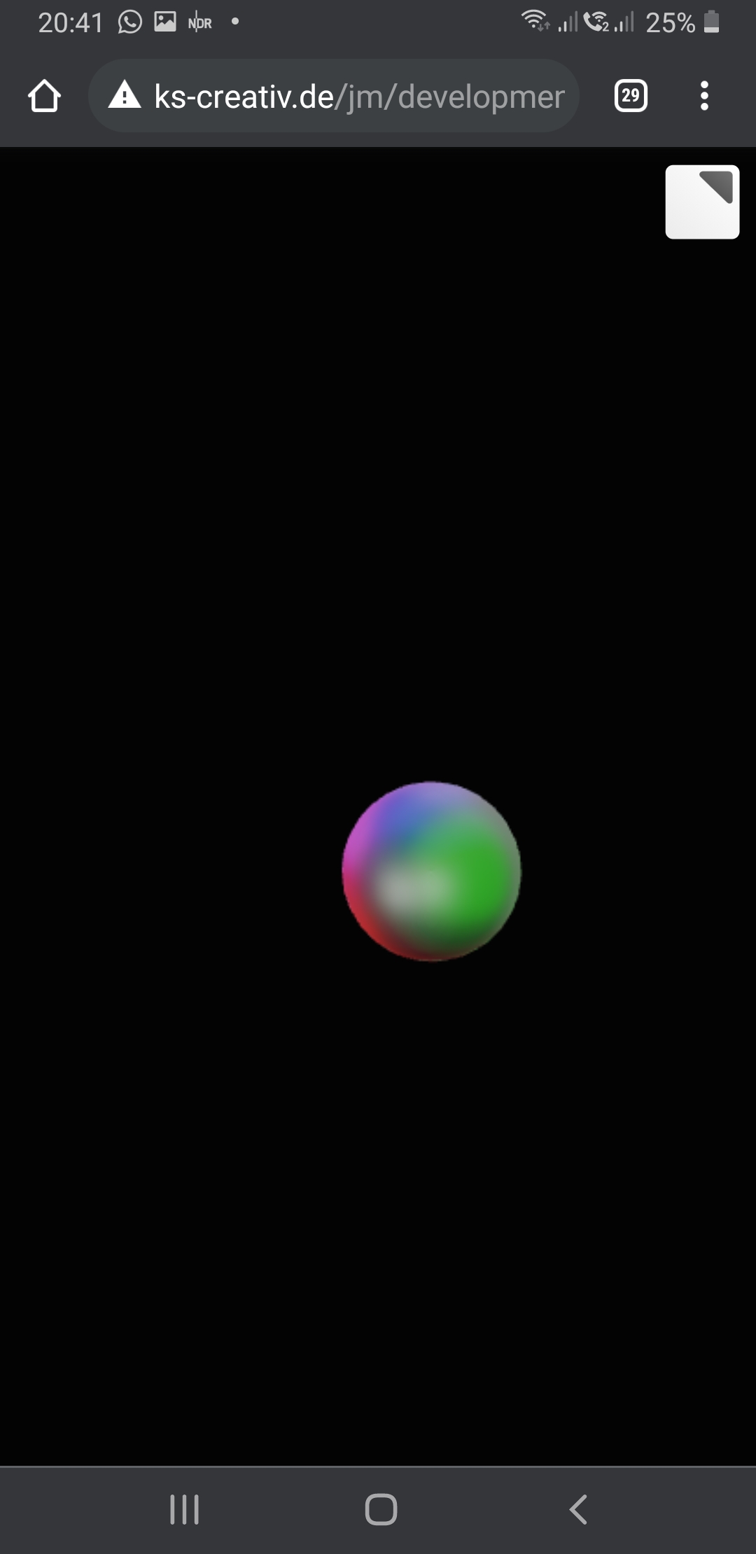

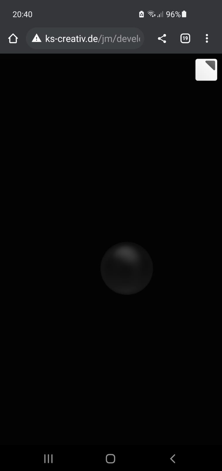

    justin_blender
    Hello,
    I have got another problem with Area Lights. Scaling setting doesn’t solve it.
    All my test devices are displaying them correct, except Samsung Galaxy S8 and Samsung Galaxy S10 seem to have a problem with the color or even at all. Probably a GPU interpretation problem?
    See attached
    – a screenshot from a Samsung Galaxy A6+ (correct display)
    – a screenshot from a Samsung Galaxy S10 (greyscale area lights)
