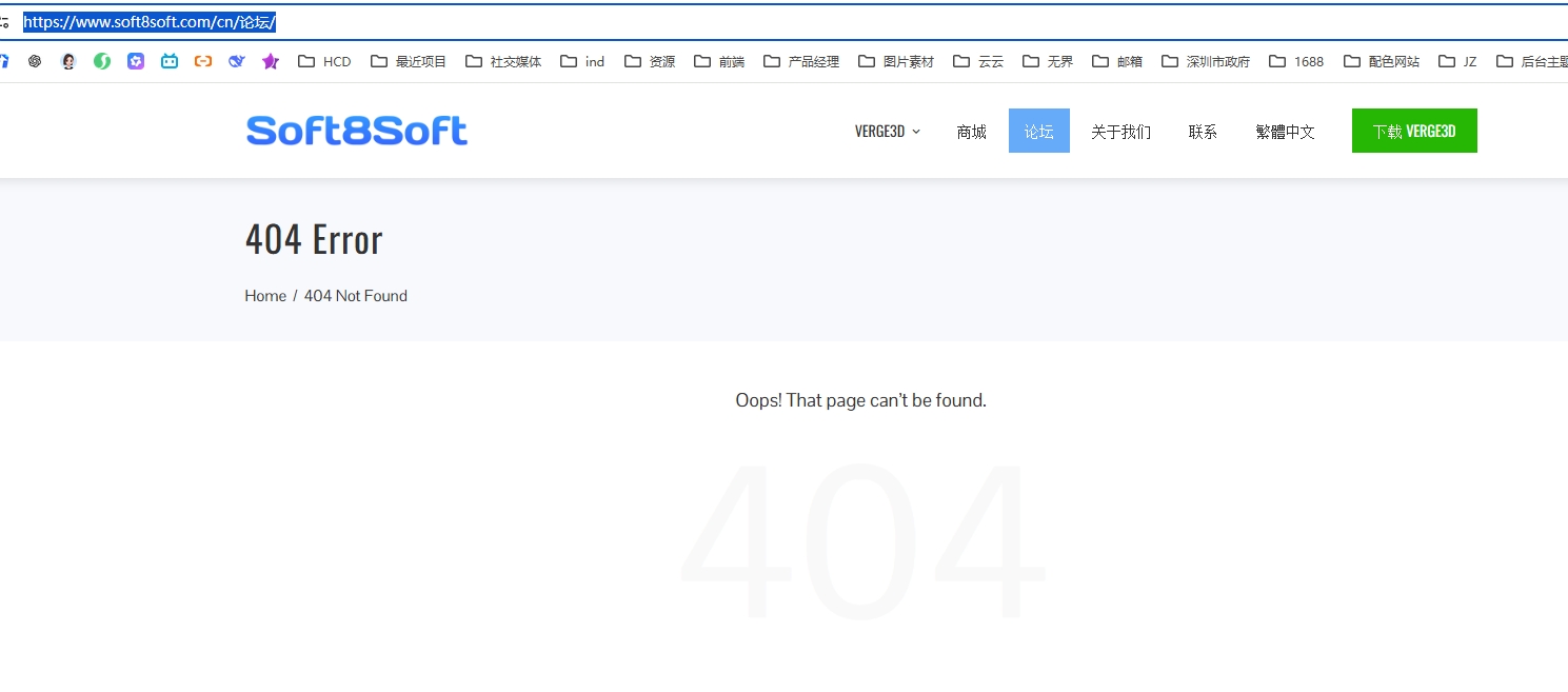

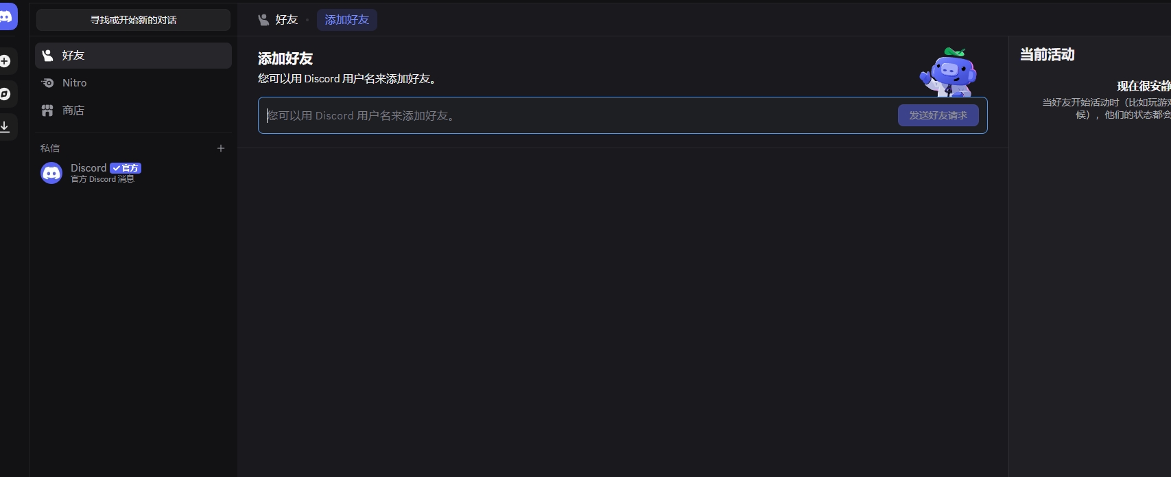

    Alexander, thank you very much for your response. The Chinese forum you mentioned (https://www.soft8soft.com/cn/论坛) is no longer accessible – it shows a 404 error. Additionally, regarding the Discord channel, I haven’t used this platform before. Who should I add to get technical support?
    #82539
    mojito1999
    I close the VPN,the forum for cn is working

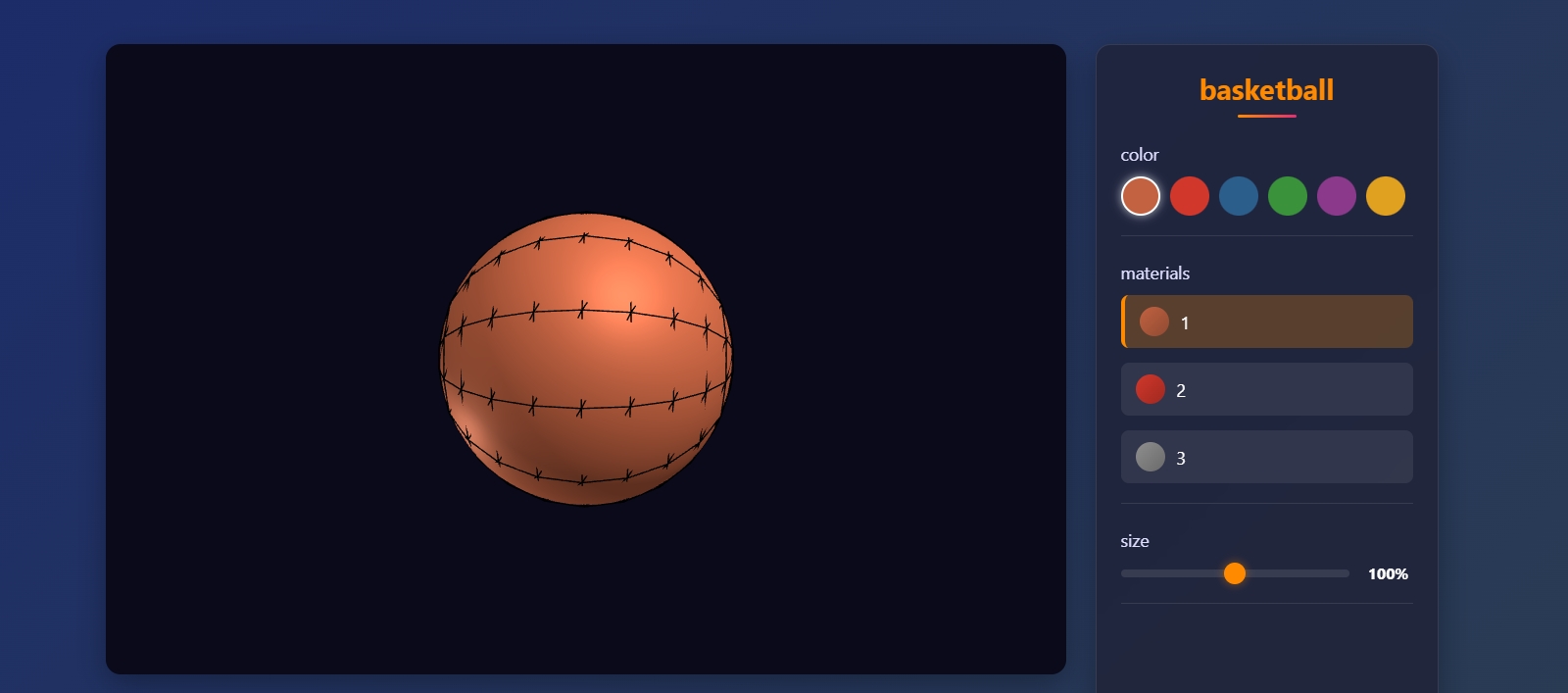

    “To be more specific: Our clients provide completed Blender 3D models, while our team focuses on HTML/JS development. The critical task is implementing controllers in HTML pages to manipulate 3D model displays – for example, enabling users to select different colors, dimensions, materials, etc., achieving real-time rendering on the webpage.
    My key questions are:
    Can the free edition of Verge3D deliver such functionality?
    What would be the estimated development workload for this implementation?
    What are the essential coordination points between 3D modelers and developers during this workflow?”
    thanks,waiting for your reply.
    #82542
    That you intend to do is the 3D web configurator, and this is the thing that Verge3D is really good at! The required efforts to create such an app would depend heavily on the amount of web content and modelling. The parts of the app that deal with Verge3D would require minimal coding. Also, to speed up development even more, we’d recommend using Puzzles instead of JavaScript, though it’s not mandatory.
