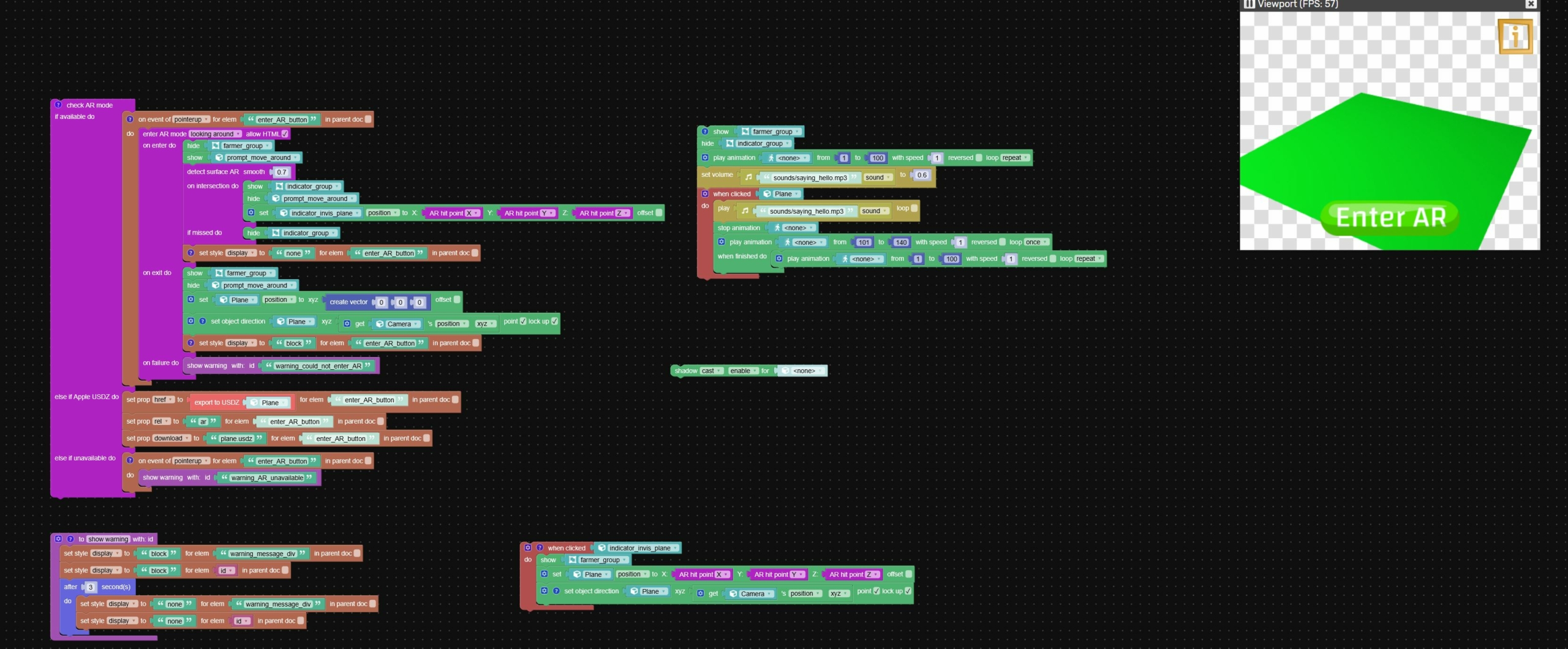

    I have replaced the farmer by a simple plane to get started building my own AR app. But the plane is not showing. After starting the AR app, it is “loading” in the phase before the look-arround” message.
    direct link to app.
    https://v3d.net/e5o
    blendfile and puzzles below
    I have had this issue before but that time is was the material being not to verge3d standard.
    Now it is only a simple color. So material is fine this time.
    Any idea what go’s wrong?
    #59995
    The app is working in WebXR mode, but you’d better move the plane from camera_and_text_group to farmer_group and parent the spot light to the plane. and remove customs (with all objects inside). To make it work in iOS Safari enable this option for the plane’s material
