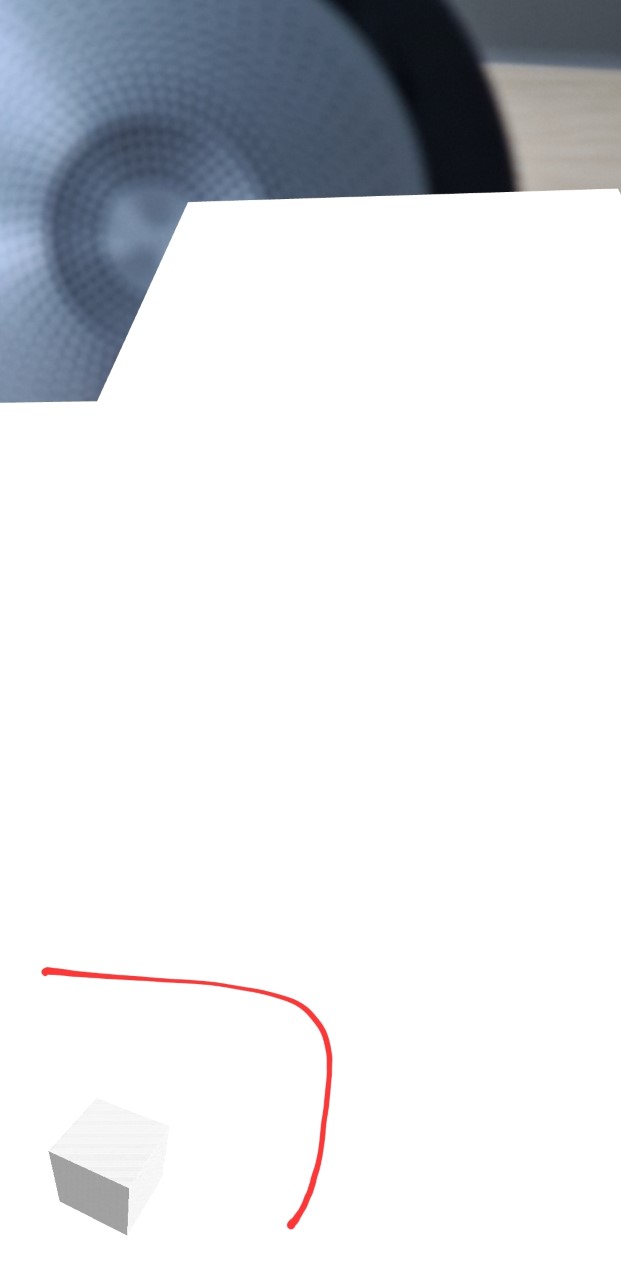

    We have come across interesting bug on variety of different Android devices in AR mode. When we anter AR, everything seems to be working fine but when object reaches bottom left corner of the screen it shows some shadowy overlay on top. At first we were like “wtf is this image” but then we found out its actually smaller version of how picture looked like immediately before clicking “enter AR” button. Some postprocessing residual image or uncleared buffer maybe?
    – We have some html for model positioning on left bottom corner but this bug persist even if we delete it completely from build
    – Verge is 3.9

    We were unable to identify any particular effect which is causing this issue. Adding both html build and blender scene with plain cube which is doing this “ghosting overlay” on bottom left corner when entering AR under Android device (+ positioning scene so that bottom left corner contains 3d object) as shown in screenshot.
    Looks like it is linked somehow to version 3.9.
    thank you very much in advance,
    Petr from Precismo
