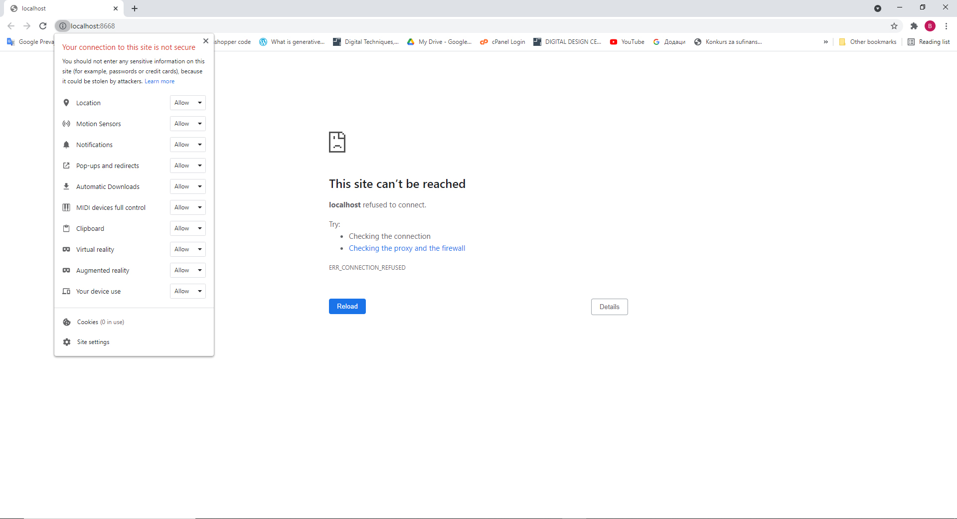

    I downloaded the latest verge3d for 3ds max release (verge 3.7.1 max 2020). After installing I tried to run Sneak Peak and App Manager, but I get error in Browser: This site can’t be reached localhost refused to connect.
    I read details on this page, and I disable firewall for chrome, but the problem still persists. Do you have any idea how to make it running?
    Thance in advanced.

    I tried to reinstal google chrome, turn off antivirus add all permisions to the site localhost:8668, but it still doesn’t work. I also installed verge3d for blender and have the same problem with the blender.
    Does anyone have idea, why I can’t load app manager?
