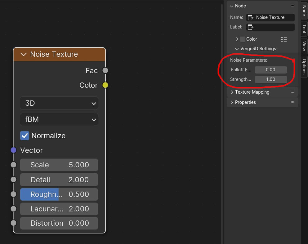

    Try to play with this parameters
    here’s an explanation how it works DOC
