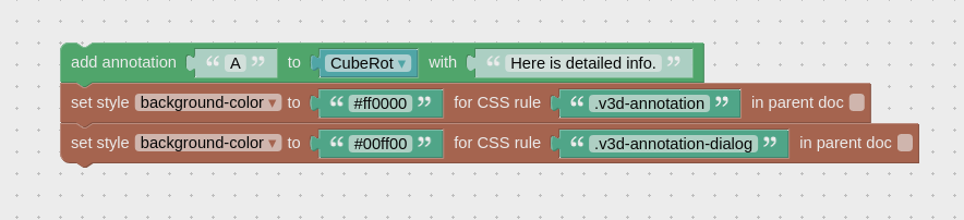

    Can we somehow change the look of annotation, background colour , shape ?

    With the latest 2.7.1 update it became possible to configure annotation style with puzzles. For instance, the following puzzles paint an annotation red and change the color of the expanding window to green.

    Awesome Yuri. Seems to work quite good. Will other style features also work, such as opacity?
    Cheers
    PS: Got it! Instead of using Hex color we can use “rgba(76, 175, 80, 0.1)” values being the first ones Red, Green and Blue and the last one opacity (from 0 to 1).
    Attached image as example for a great semi transparent background without border
