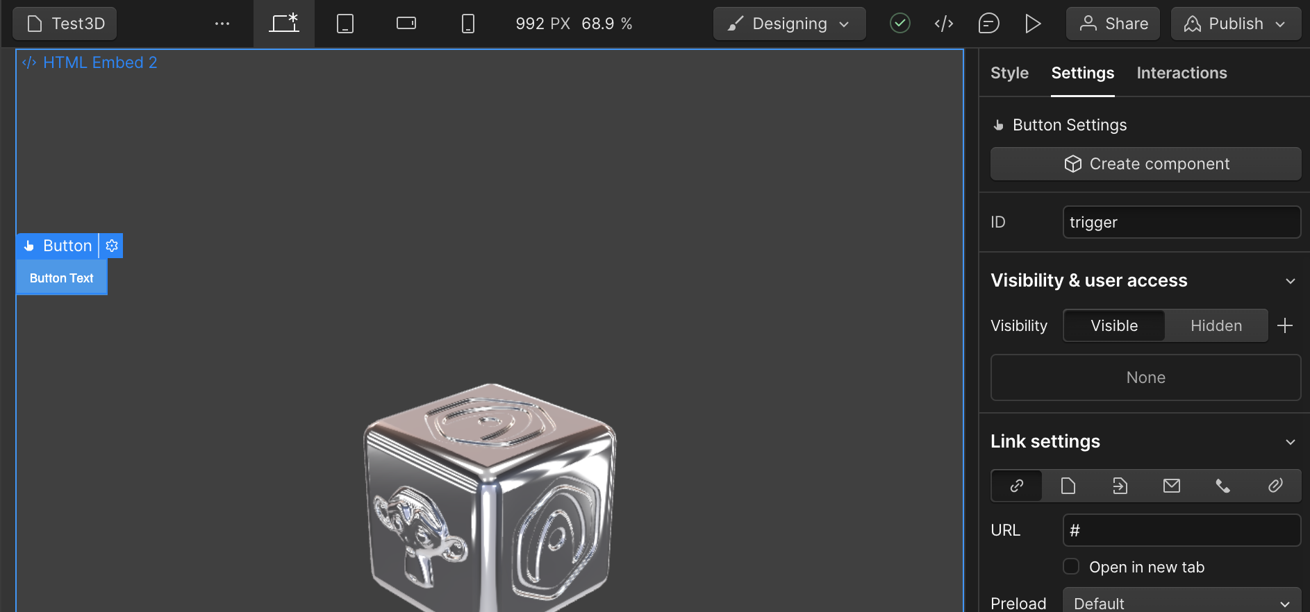

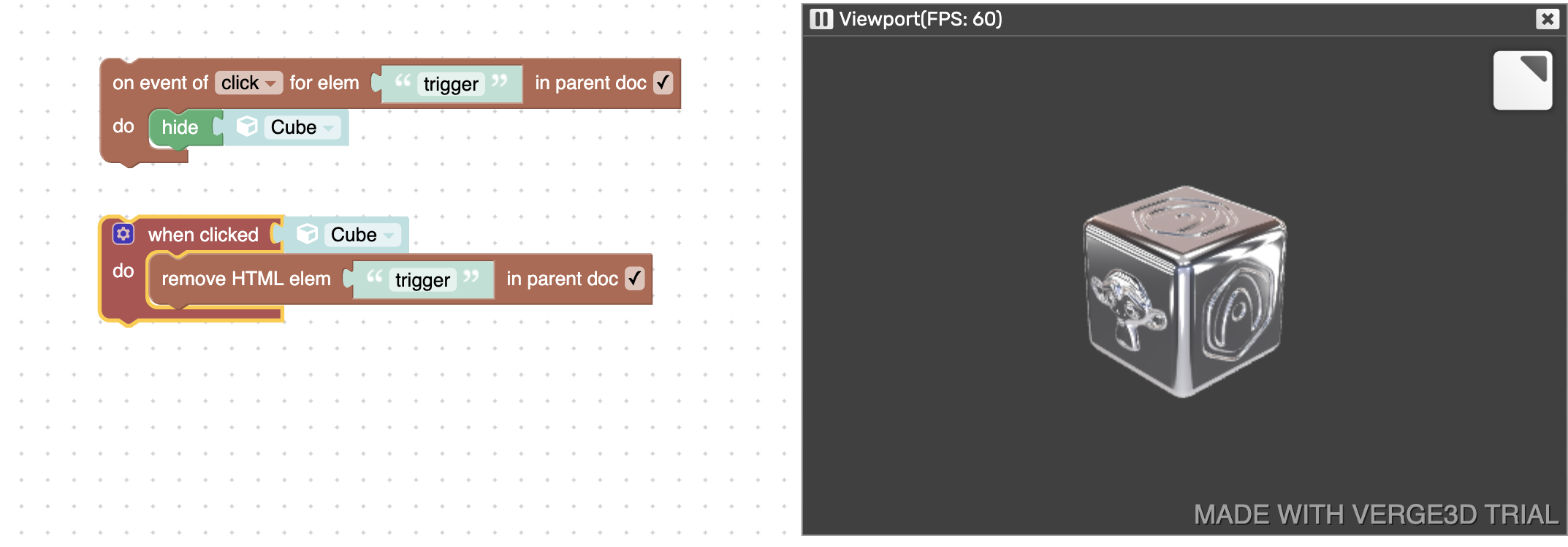

Spent the last few days playing around with verge3d, which is pretty awesome (Blender workflow). However, I’ve hit a snag which I can’t seem to find the answer for. My background is design, but I’ve got some basic understanding of coding.
In the tutorial (Verge3D for Blender basics), Webflow is used to create code and export it. This is all fine and works as expected. However, this method essentially is just a shortcut to writing HTML/CSS by hand, and decouples the code from the Webflow builder.
What I want to be able to do is keep a site maintainable on Webflow, and have Verge3D affect elements on the Webflow site.
In this simple example, I want; Clicking on the cube to hide the button, or clicking on the button to hide the cube.
Attachment 1 shows the puzzle setup
Attachment 2 shows assigning of id to button (‘trigger’)
For the embed I’m using:<iframe width="100%" height="100%" frameborder="0" src="https://cdn.soft8soft.com/AROAJSY2GOEHMOFUVPIOE:4d1c2599b1/interaction_tests/interaction_tests.html"></iframe>From what I’ve gathered online, I’m thinking maybe it doesn’t work because the two projects are hosted on different domains, so I think security blocks them interacting with each other. although I could be wrong.
What are the options here. How can I make this so elements on my Webflow site affect elements within the Verge3D iframe and vice versa?
I guess one option would be to write the site code by hand by whatever means and not use Webflow. However, I would lose the benefits offered by Webflow. Also thinking ahead to potentially using it commercially, I would prefer to still use Webflow primarily.
Files can’t be uploaded to Webflow (at least I don’t believe they can), so moving all the files from my local computer to the Webflow file, to get them on the same server/domain(?), rather than hosted by Verge3D, is a no go.
