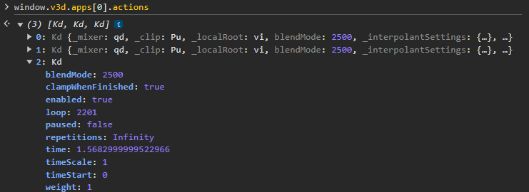

    but I get an empty array in clips. Same goes for objects.animations in scene, app.animations or app.scene.animations – all empty arrays
    all animations are here app.actions :unsure:
