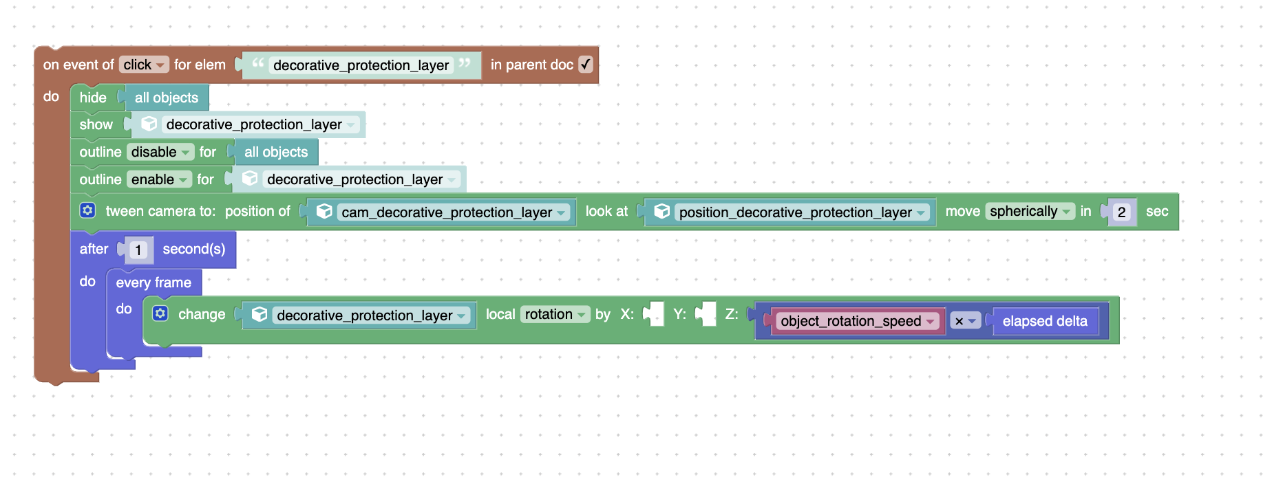

    So there are a bunch of objects in the scene. On selecting a particular object, I want to hide the rest of the objects and tween the camera to the selected object. Once the object is in focus, it needs to rotate on it’s center. I tried doing this. But instead it’s orbiting around the center from a distance.
    So how do I make an object rotate on it’s center? Like a 360 turntable rotation?

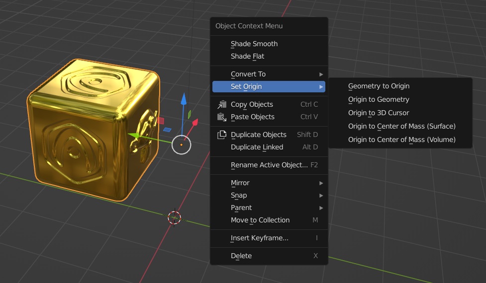

    Usually this occurs due to the wrong location of the models origin point. The origin point determines where the object is located in the local 3D space. The origin point works as pivot point when rotating the object. You might try setting it to the center.
    Verge3D Developer

    A different approach would be to rotate the camera instead of the object. In this case you can use the “AutoRotate” puzzle.
    Once the tween to the position is complete just activate the Camera Auto Rotate to on.

    Perfect. Tweening to the end position and then activating AutoRotate worked. Thanks.
