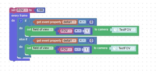

    ATGmedialab
    That’s a good idea indeed.
    But the parameter ’50’ should be driven by the mouse-wheel input from the user.
    How do we link the FOV parameter to the mouse-wheel input?
    Thanks for the follow-up.
    Pd: The attached is an idea that does not work =(

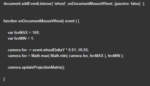

    Pd: I got this code from the web (codeFOV.jpg)
    Could you explain where to add these lines? Can I call/execute it with the puzzles somehow?

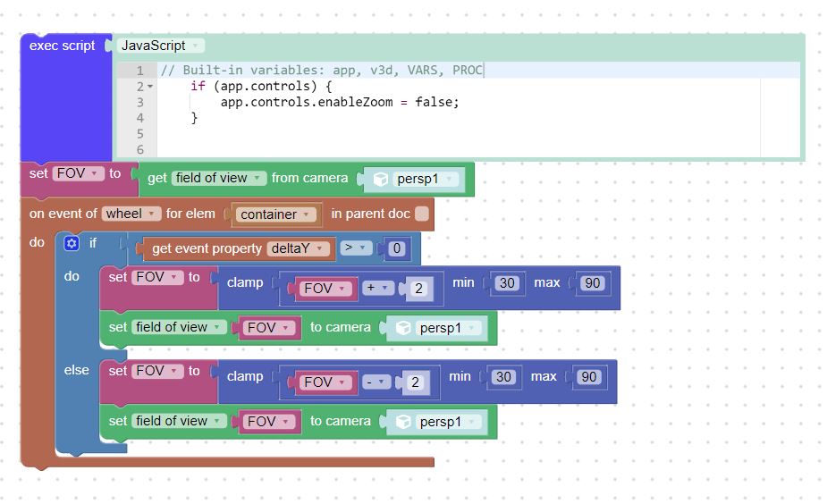

    #51949
    ATGmedialab
    Update: To anyone interested in changing the camera FOV with the mouse wheel. I post another solution I found more appropriate for my project.
