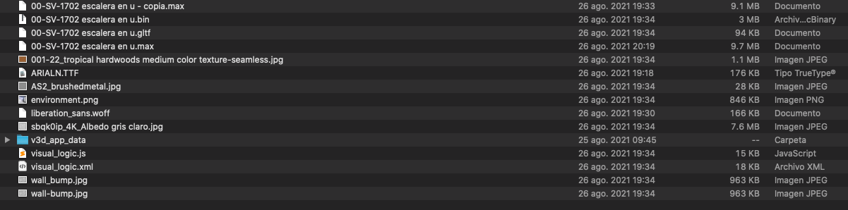

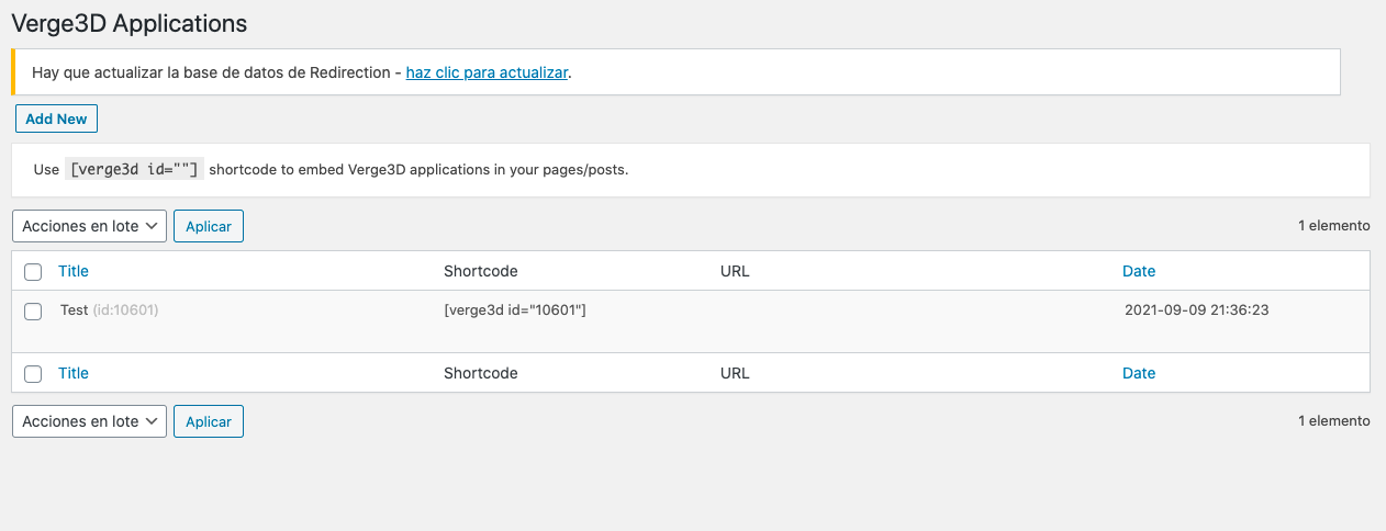

    Hi! I have a question for plugin usage: Im uploading project folder without problems (its appears at uploads/verge3d). But i cant view render at shortcode.
    Im reading the documentation and i cant find the correct file formats either. Here goes a screenshot of my project.

    can you check if the .html file is uploaded? Also please note that this WordPress plugin cannot work with player-based apps (that is, without an .html file).

    I havent the .html file. Should I create it? Do you have any tutorial/instruction for that?
    #44702
    Perhaps you used one of the player-based apps as starter project. Usually the .html file is generated automatically when you create a new app in the App Manager.
