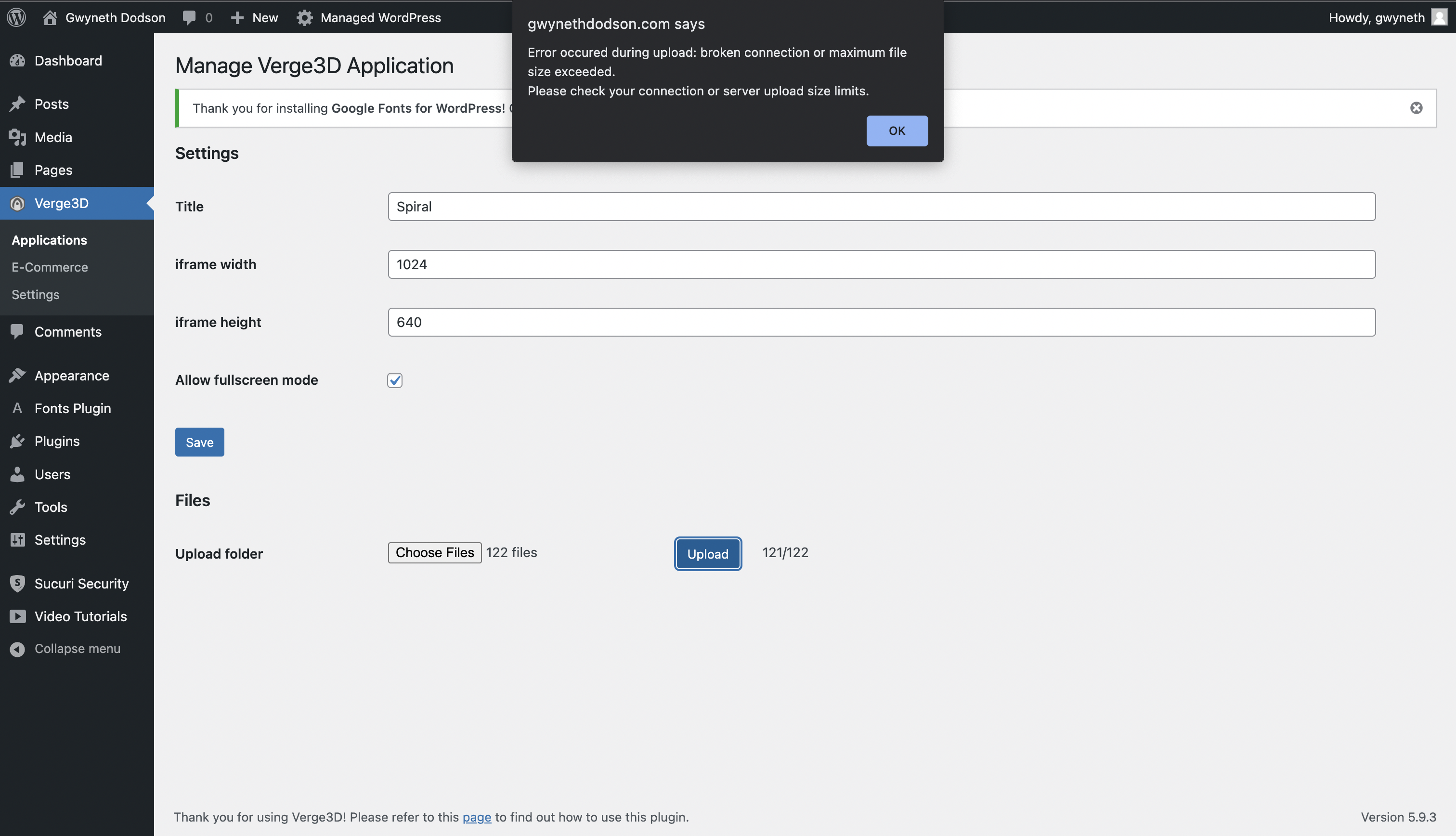

    I am trying to upload my project to a WordPress managed site in GoDaddy. When I upload through the plugin I get a size limit error. I contacted GoDaddy and they increased the limits of the php.ini file. I still could not upload my project so I uploaded the cube sample and then replaced all the files with mine through FileZilla. I used shortcode and I can see my project on my site, but none of the puzzles are working. How can I make them work?
    Thanks for your help!
    php file:
    memory_limit = 1000M
    max_input_vars = 3000
    upload_max_filesize = 1000M
    post_max_size = 1000M
    max_execution_time = 1000M
    #52438
    for puzzles to apply to your project it is crucial that you upload the file called visual_logic.js.
