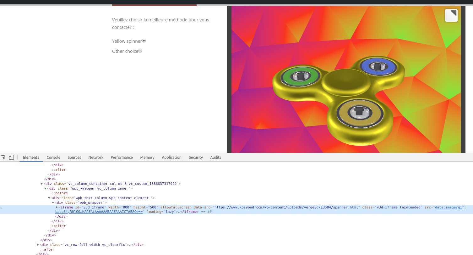

    I want to put my input in a wordpress page and connect it to the verge3D plug-in.
    To be more clear, I would like to have a form in a standard wordpress page which affects the values that I have configured in the verge3D puzzle.
    I used an attribute
    On event click with an id in parent doc, but it don’t work.
    So is it possible ? And if yes ? What did I missed
    Thanks for the help

    Hi Yuri,
    https://www.kosyood.com/module-3d-20m-sdb/
    In this page you can see your spinner with a form on the left. I put the id test on the yellow spinner and I put the on event click for test on the puzzle.
    I saw that if I put on parent doc I could used some html tag outside the iframe. But I used the verge3D plugin
    Regards
    #25691
    Yes, the WordPress plugin uses an iframe to embed Verge3D app. So you can use in parent doc checker to access any HTML elements from outside.

    I tried all the methods. I do not understand how to put my button in wordpress so that it performs the action in verge3D.
    Do I need to put an onclick action for it to work?
    Best Regards
