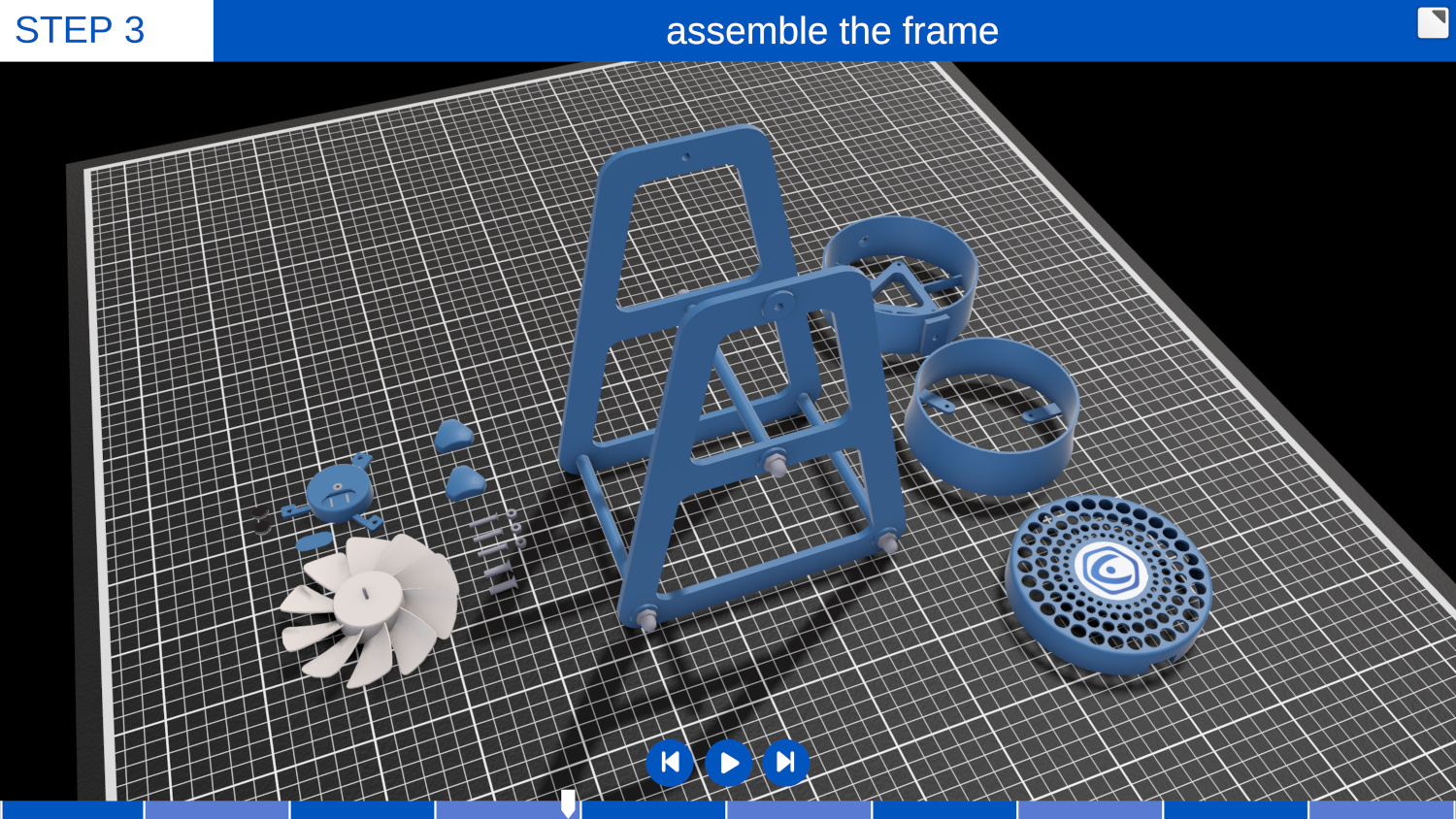

    How I can make UI created in Blender clickable for embedded links? UI works as expected if published on verge 3d portal but it doesn’t if I embed it to other cms.
    I attached e-learning UI as an example for my issue.

    The key thing I believe you are saying is its working as intended…but doesnt work as you have implemented it. CMS’s (there are so many and work so differently) often require modification to the paths within the CSS, HTML, JS…etc. of your V3D files for them to work directly within the frame work of a particular CMS. The issue is not what you are doing in Blender or the puzzles…its all the things you need to do to make it work on your CMS and associated server…. more than likely.

    that’s usually the main problem when embedding V3D apps via iframes.

    Checked this app in iframe, and it appears to be a bug in SCORM puzzles. Going to fix it in the upcoming Verge3D preview.
    In general, Verge3D applications should work in cross-origin environments, provided they don’t try to get access to the parent namespace (e.g via “in parent doc” checkbox of HTML puzzles or so).

    Fixed!
