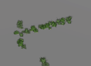

    I mapped some bushes to a simple plane and added an alpha.
    In Verge3D I get some white artifacts around the alpha border (I´ve attached an gif showing the issue).
    The white pixels get more prominent the further away the camera is. Close-Up they are not visible at all.
    I´ve tried PhysicalMtl and StandardMtl and all possible transparency settings.

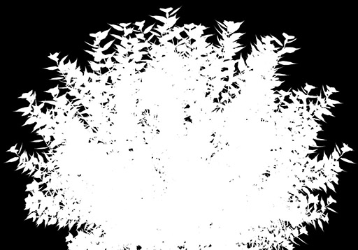

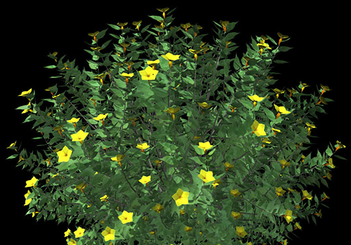

    Not sure if this issue is caused by the very fine detail in the alpha map. I´ve also attach the alpha and diffuse map I´m using.

    Hm, I have no such artifacts when tested a scene. What hardware do you use for testing? Can you test your scene on another computer?

    #38064
    It’s apper in sneak peak too or only when you export to the gltf. May be there some additional post-processing effects on the scene? Try also to play with blend type of the material by switching it to Mask type.
    #38067
    jamjam
    It appears in both, sneak peak and exported and also when using different blend types.
    I will test exporting it from a different computer with the latest 3.6 version later today.
    I will let you know if this fixed the issue.
    #38083
    jamjam
    Exporting from another computer with 3.6 fixed the issue.
    Thanks for your help!
