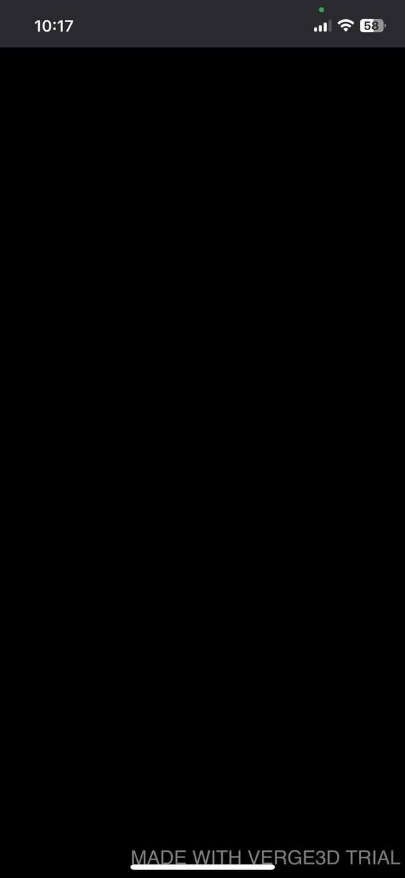

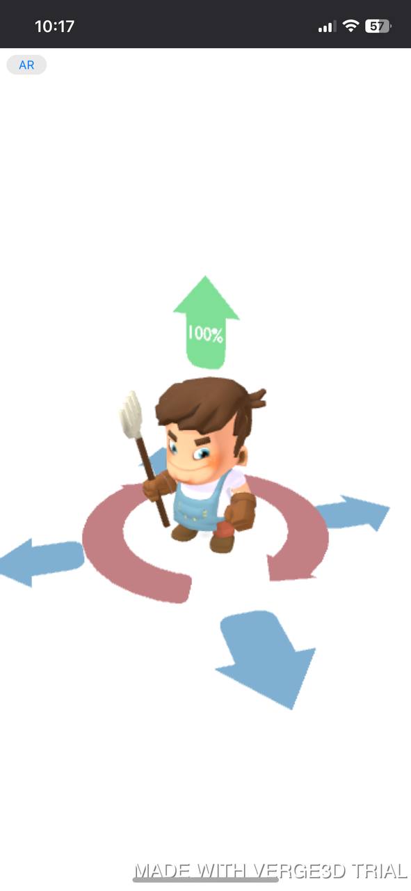

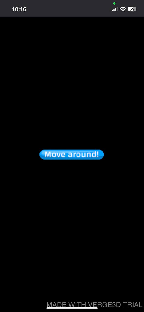

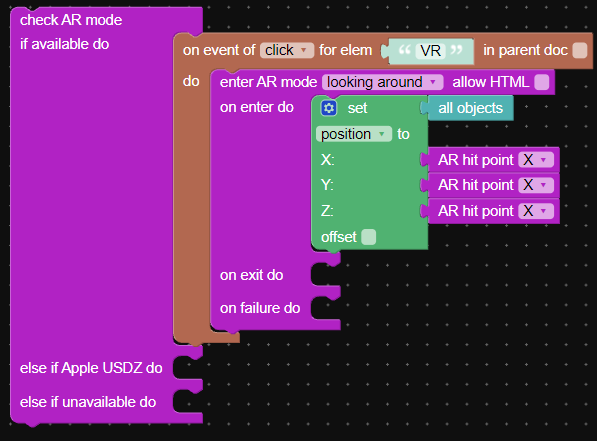

    Good day to all. I need help. I’m doing programming. I came across a very cool Verge3D engine. With the help of your Puzzels, I decided to launch AR of my model, but when I enter, the model always appears at coordinates (0, 0,0) and the AR camera itself also appears. I tried to make a copy of the Demo version of AR Farmer. But the result is identical. I appear in a model and a black environment. I’ve already tried everything. I launch my configuration from iPhone 12
    I don’t know what to do, I’ll attach photos below
    #75787
    Looks like you didn’t enable the “transparent background” options on the Init tab.

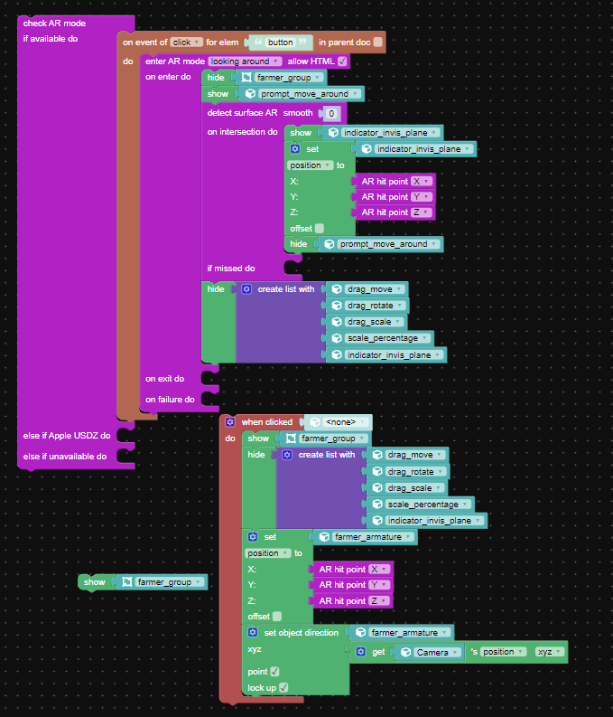

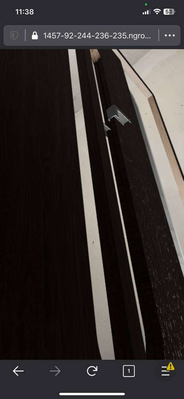

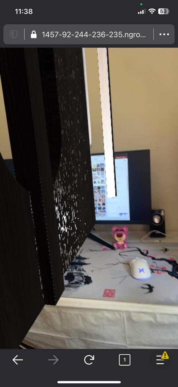

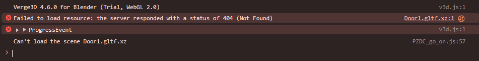

    Thanks, it’s better, but still the model is positioned not on the table, but in the place where the camera appeared. And my code started asking for compressed bin and gltf resolution in xz format. Is there any way to get around this?
    #75816
    It appears you have accidentally activated asset compression in Puzzles, but have not done so in the modelling tool.
    I also see you have set coordinates from AR hit point with triple “X” which might not be what you really want. Try XYZ.

    And really, thank you very much
