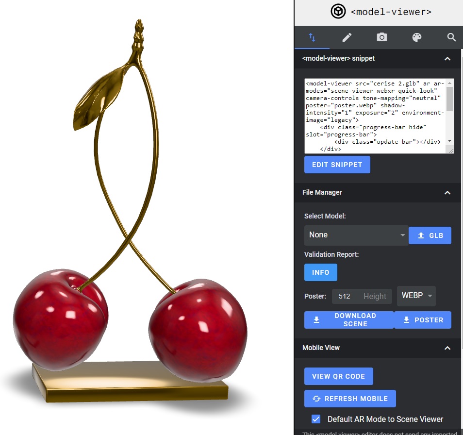

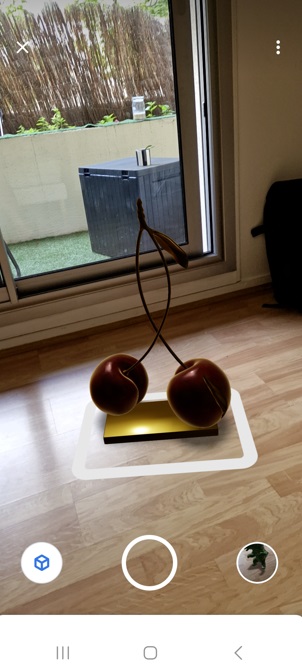

    On the other hand, the <model-viewer> works fine. My Samsung S22 doesn’t freeze and display the object correctly.
    Would it be possible to create a puzzle that could export my object once it has been configured using <model-viewer> ?
    I bought an addon with Kdv doing exactly this by exporting a USDZ for QuickLook on IOS and I wonder if we could do the same for android ?
