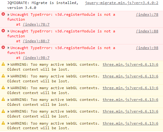

    #63621
    Looks like you are using three.min.js for the animated background. And this three-based animation causes the problem on the window resized.
    This animation is visible only when the slider is on the right. When the slider is below the head this animation is not visible and the issue doesn’t happen.
    Even when no v3d apps are launches the problem still exists
    #63624
    Webenart
    for the register model is not a function is something that i tried for the moment you refreshed the page and it was wrong.
    but for the three.min.js yes it is true, i am using slider revolution for the background that uses i guess also webgl. and if i remove it then i dont get the error.
    The truth is that I would like to use both though. If you have any idea on how i can do that.
    Webenart | Creative Websites
    webenart.com
    #63625
    and it allowed to see that even without v3d apps loaded the problem is only in that animation.
    First, use that script without three.min.js. It can work with v3d.js. And maybe there is an updated version of that script. In fact, the problem is not in three.min.js or v3d.js. The problem is in the script that generates the background animation.
