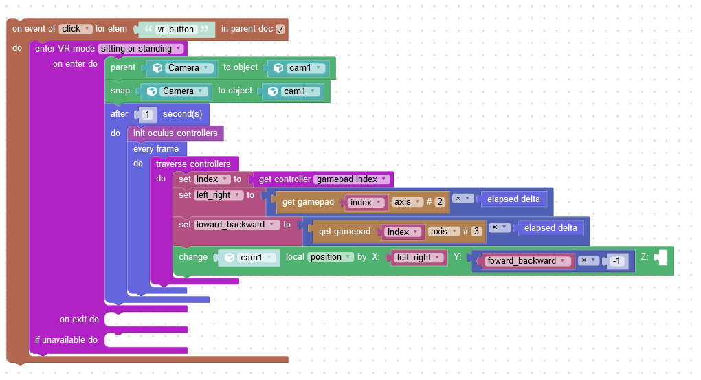

    ocularvr

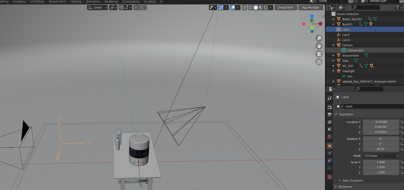

    Thank you so much for your help. I got it working on Sunday night – I set the camera straight in Blender and made the following puzzle. Now I am going to make a function that rotates the camera by 20 degrees every time we press a button. For that, I have to figure out how to get an event for A or B button on the right hand Quest controller. Any ideas would help me very much.

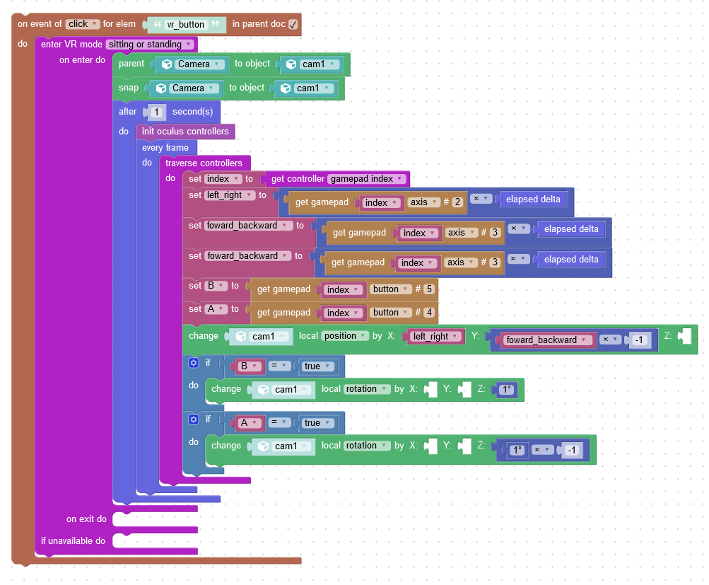

    ocularvr
    OK have it working with one controller, going to get some batteries now and try to modify it so that the left thumbstick is rotation while right thumbstick is position.
