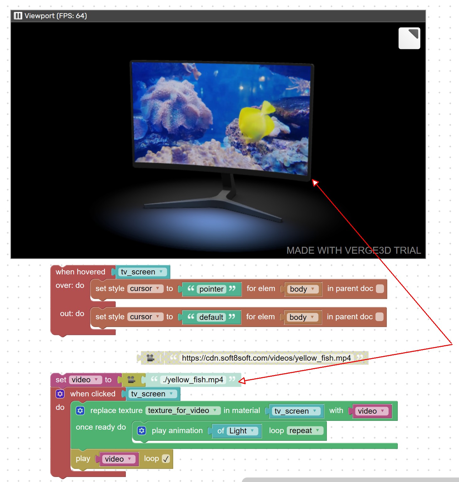

Avier3DCustomerHello,
In the video texture app demo, I can’t get relative path to work.
I placed a copy of the video in the URL at the root of the project, but when replacing the address to that relative path, it does not seem to read it.Something is quite obvious but I’m missing it?

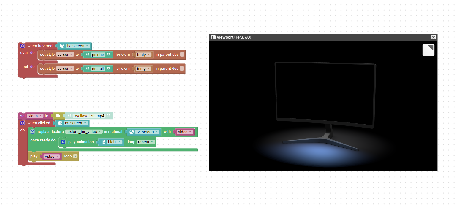

Avier3DCustomerHi,
Thanks for reply.
No example file, it is the same video texture example that comes with verge3D, anyone can replicate it. The attached screenshot explains it well.Like I mentioned above, I placed the online video file locally, in the application root folder, and change the path to ./yellow_fish.mp4
Not a case sensitive problem.
Tried different workstations, and different locations (locally, not on my studio network)Does not load.
A mate tried on his setup and is having the same issue.Where is the issue being generated, local path syntax?

Avier3DCustomerHey,
Yes, that is the strange thing, I have the same setup but video does not seem to load after the change. Same video file in the root folder, hence the “./yellow_fish.mp4”, but does not load.
I tried different browser too.anyone else running into the same issue? Seems to be something dumb but can’t find it :/
