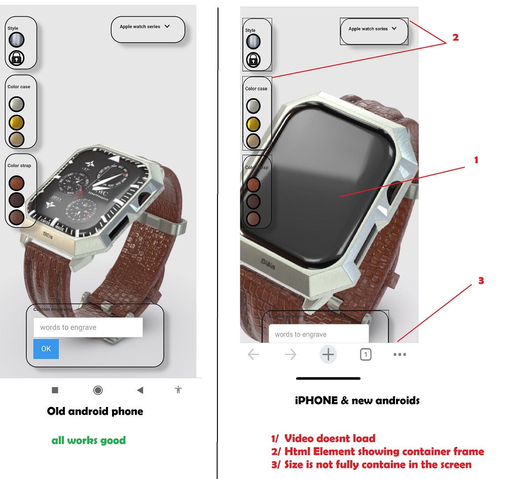

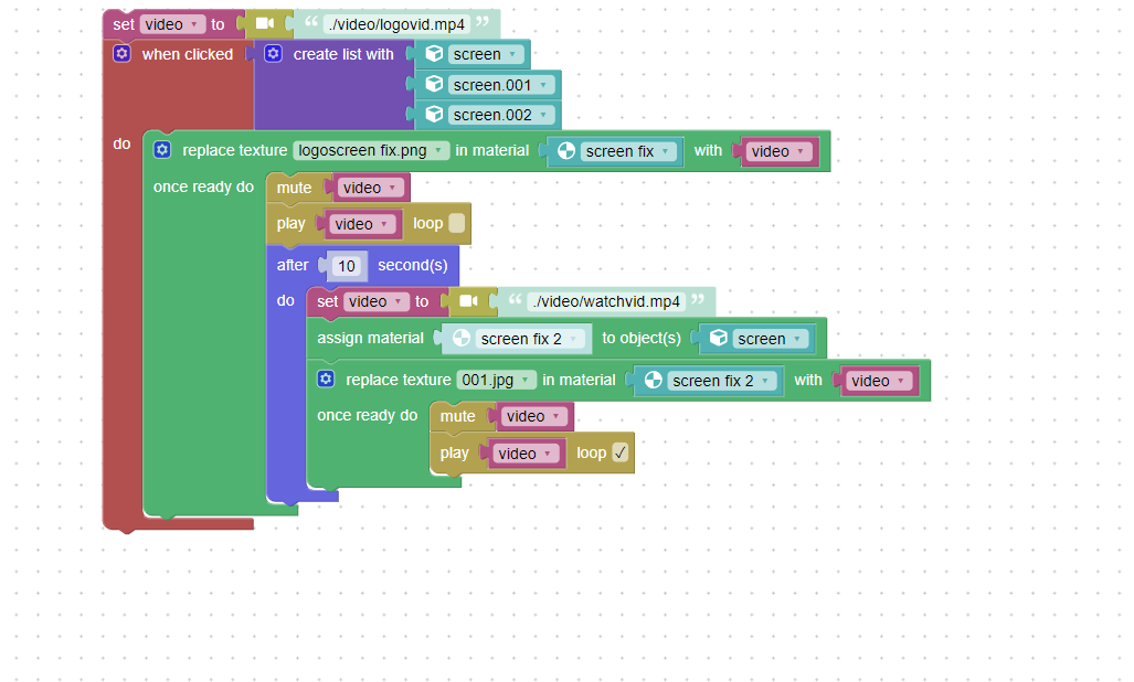

    I have created a project that includes Short video inside node texture, All works fine on Laptops BUT… the video doesn’t load on Iphones and new android ! it does work on my old android phone which is definitely not something related to memory but probably to new Version of IOS and Andro , Would you please investigate that ?

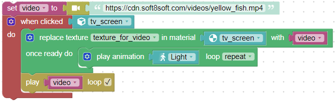

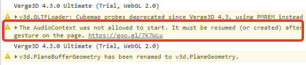

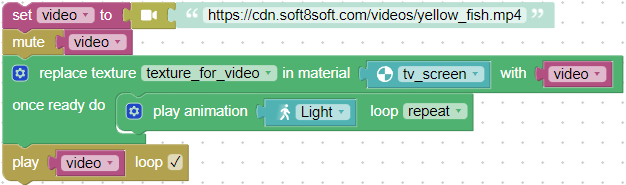

    Your video is not muted. The autoplay function is not allowed for sounds and unmuted videos without a user interaction. If muted your video will work with no problems in Android
    https://v3d.net/ii4
    As for iOS and Safari: they are from some other universe. Even muted videos won’t be autoplayed without a user interaction…
    Check out the “Video Texture” demo.
    This variant is working in iOS.
    This one isn’t.

    However, I took your advice and tried so many things , Muted/unmuted , autoplay//user interaction… still not working , now even in my android device.
    Do you think there’s is other optimal video format unlike .mp4 ?
    I let you investigate this with your dev team

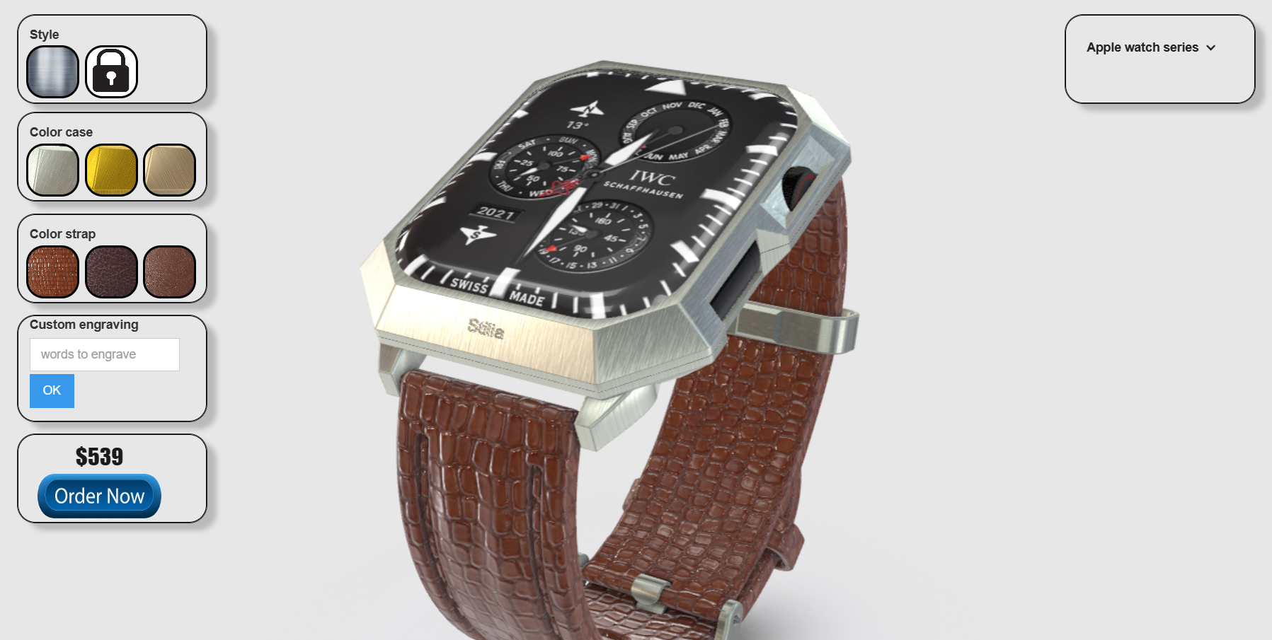

    Your video is not muted to be auto-played
    And it works in Chrome (desktop/Android) after clicking the watch face…

    I am confused,
    am i doing it wrong ?
    #63339
    it works according to you logic. See no problems.

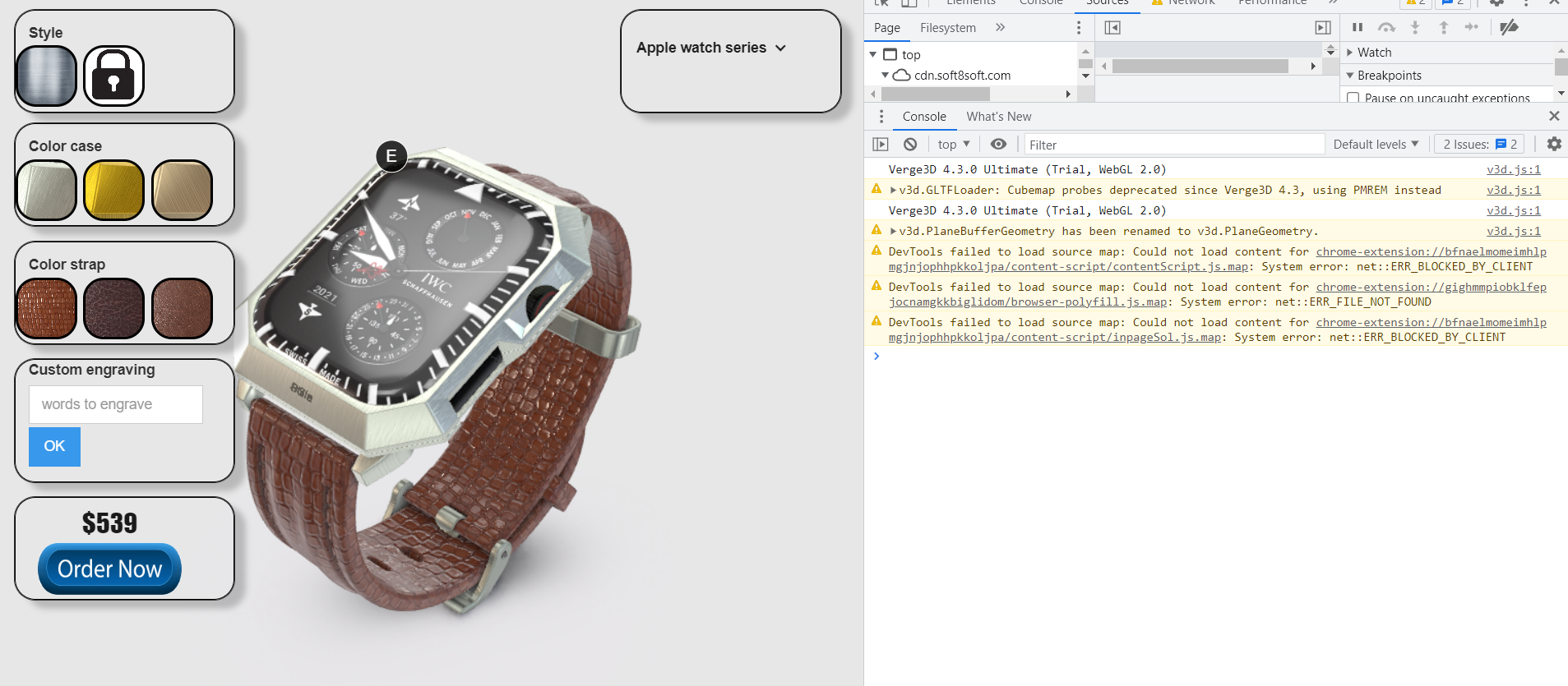

    #63342
    press F12 in your browser and refresh the page
    #63343
    aitwattman
    please double check that on your PC/MAC works fine but still not working on phone
    #63345
    but still same issue on phone
    On my side only Safari refuses to play video. Have no idea why. iOS is such iOS…
