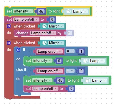

2023-01-20 at 9:29 am #59698matthijsbinmat
Customer2023-01-20 at 9:30 am #59700kdv
Participantjust show/hide your light source when you click on the mirror…
2023-01-20 at 9:53 am #59701matthijsbinmat
Customeror like that…

2023-01-20 at 10:13 am #59704
g.grangerCustomerThanks Mathijs, I’ve tried this but I don’t know what I’m doing wrong why it doesn’t work.

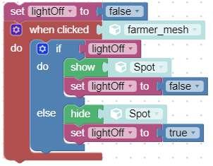

2023-01-20 at 10:14 am #59706kdv
ParticipantDo not add
when clickedpuzzle twice for the same object. Use logic and variables.
If your light is initially hidden then add
showpuzzle in the beginingPuzzles and JS coding. Fast and expensive.
2023-01-20 at 10:36 am #59708
