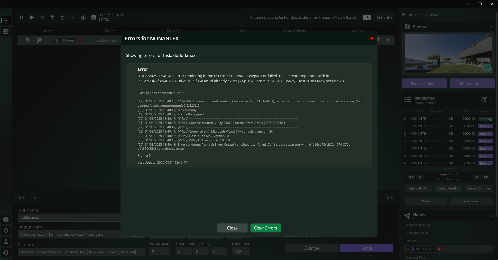

    But now i have a nice intelligible error text (see screenshot), and the problem was not backburner all thoses months / years. When 3dsmax is launching a no-GUI occurence for rendering, something is trying to create a menu separator, can’t, and crashes.

    “CreateMenuSeparator failed. Can’t create separator with id ‘e16cd………35a3a’. Id is already in use.”
