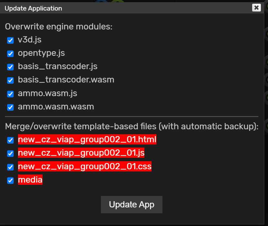

    Ater selected APP update (printscreen enclosed):
    – Updating application: new_cz_viap_group002_01
    – Updating app module v3d.js
    – Updating app module ammo.wasm.js
    – Updating app module ammo.wasm.wasm
    – Backup new_cz_viap_group002_01.html
    – Updating app file new_cz_viap_group002_01.html
    – Performing 3-way merge… success!
    – Backup new_cz_viap_group002_01.js
    – Updating app file new_cz_viap_group002_01.js
