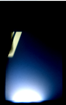

    Good morning, thanks for your answer, but using emission in a physical material the results obtained are like a big led screen. Screenshot attached of tests
    #24788
    Or you can try to add this map to the base color map using Compozing node. Unfortunally, we haven’t any aproven pipeline for such visualisation, so you will be need to invent your own on you own taste and needs. Try to connect it in different way to get good result.
