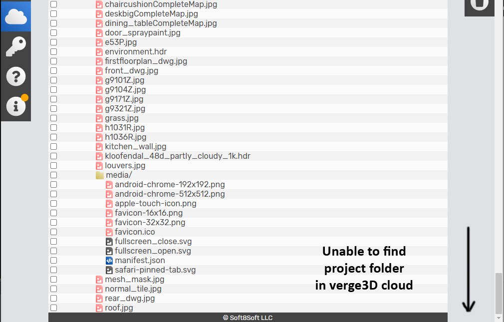

    I have a few projects uploaded into Verge3D cloud server. However, not all projects are shown in the App Manager listing.
    I cannot even select or delete them per say.
    Anyone has the same issue?

    Sorry for late reply. Yes. Those projects are actually uploaded and the web link works fine. It seems I am allowed to view only 7 projects in my cloud App Manager. Whenever I upload a new project, the ones alphabetically at the bottom will be unviewable. Thus, I have to unload some projects so I can view the hidden ones.

    I have 12 projects uploaded in Verge3D network. All the links work fine. Yet, when I press the Open Verge 3D network directory from App Manager, it only listed 7 projects in the directory.

    I just installed Verge3D for Max, Version: 3.8.1
    The issue somehow resolved itself. Now I can see all my cloud project listed in the network. haha glad it worked out.
