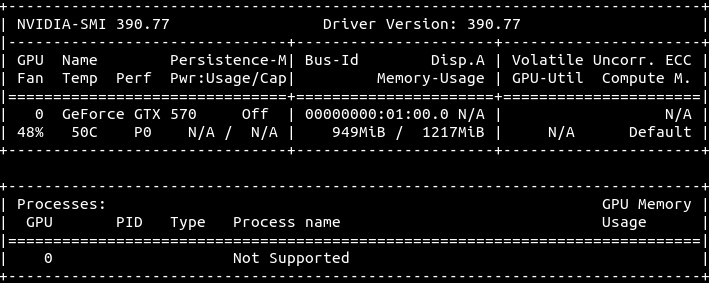

    I think when you run Verge3D on big resolutions it hits the limit of your video card bandwidth or memory. For some reason your app consumes a lot of video memory:
    Update: actually other applications running also consume some video memory. Try closing everything you don’t need during development.
