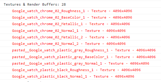

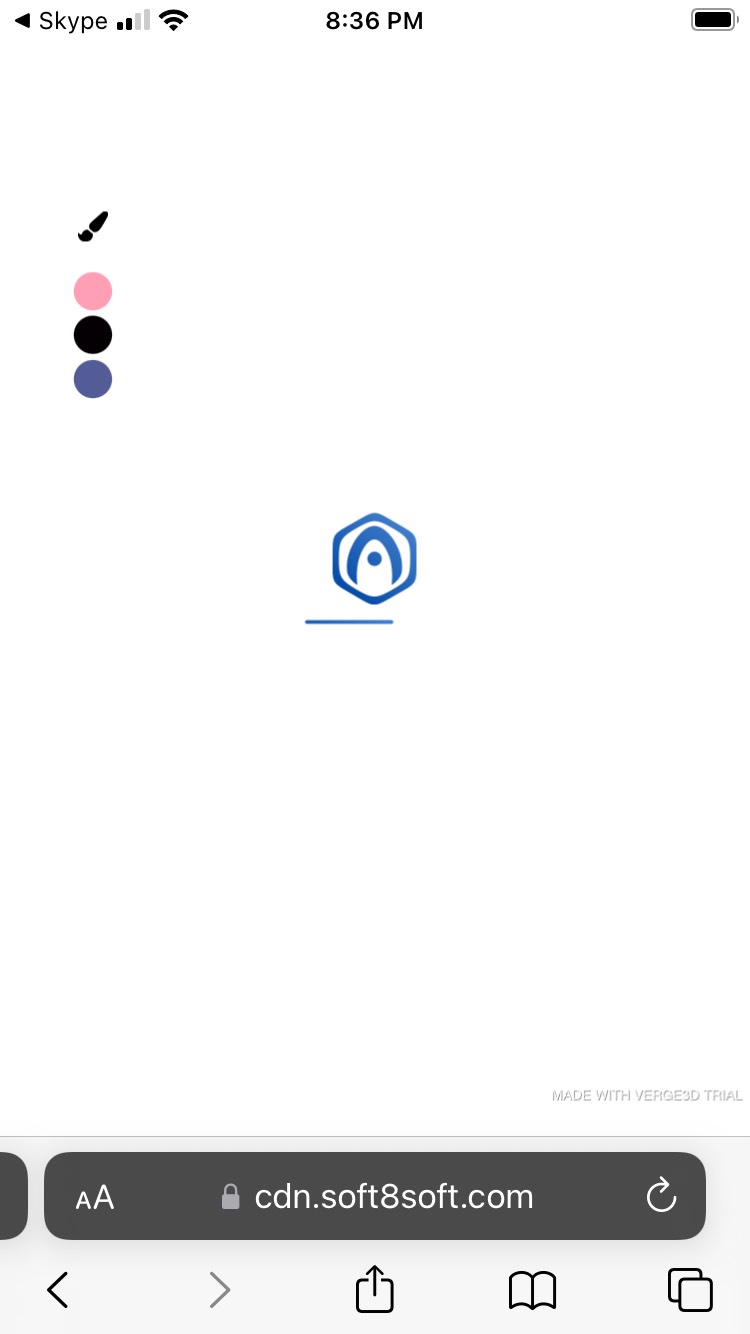

    #65309
    uvsupekar
    Hello Yuri,
    I’m unable to open the link at IOS device and loading again and again
    here is the link of my demo
    https://cdn.soft8soft.com/AROAJSY2GOEHMOFUVPIOE:be6a687590/applications/google_watch/index.html
    please help me for the same I’ve attached snap also.
    Regards,
    Umesh.S
    #65311
    Your iPhone doesn’t like 4k textures
    Your app consumes too much video memory
