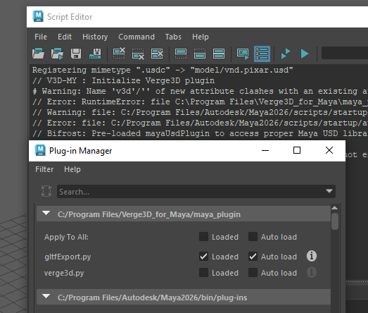

I don’t think it is a general bug outside of my system, but I now have problems loading the plugin in maya.
// V3D-MY : Initialize Verge3D plugin # Warning: Name 'v3d'/'' of new attribute clashes with an existing attribute. // Error: RuntimeError: file C:\Program Files\Verge3D_for_Maya\maya_plugin\lib\customAttrs.py line 338: Found no valid items to add the attribute to. // Warning: file: C:/Program Files/Autodesk/Maya2026/scripts/others/pluginWin.mel line 316: Failed to call script initialize function // Error: file: C:/Program Files/Autodesk/Maya2026/scripts/others/pluginWin.mel line 316: (verge3d)I had some issues upgrading to maya 2026 and made as clrean a uninstall as one can do with Autodesk products
and reinstalled Maya and upgraded to verge3D 4.9.2 from 4.8 and the above error occurs when trying to load the verge3d.py.This also now occurs with 4.8 and maya 2025., which worked fine a few days ago.
When I load a previous saved .mb file from a verge3d project the plugin loads fine. Also if I make a new scene from that same maya session. But if i turn off the plugin i cannot reactivate it.
There may be some hickups in my system that causes this, but i wanted to see if anyone here might know why that error occurs.
Im on windows 10.

PandernCustomerUnfortunately a reboot didn’t help.
“Auto load” is checked and saved with preferenses, but only working for gtlfExport.py. Get the same error during startup for verge3d.py. Se attached image.

Alexander KovelenovStaffYou might try to reset Maya settings by removing the corresponding folder (if you have not done it earlier) and then install Verge3D again.
If it does not help, save the default empty scene to the file and send back to us, perhaps something happened with it.
