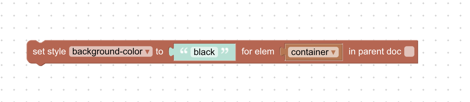

    Hi Simone,
    Indeed, there is a known inconsistency when dealing with alpha hashed transparency. The method takes a background color from the <canvas> element even if the scene background is explicitly set to be non-transparent. Please use the following puzzle to make the alpha hashed transparency work properly:

    #85838
    Unfortunately, this is more like a hardware limitation caused by how Alpha Hash is implemented by the browsers. In older versions of Verge3D this was not reproduced because transparency was disabled for the 3D canvas, but now we are forced to always enable it. So this Puzzle is more like a feature than a workaround.
