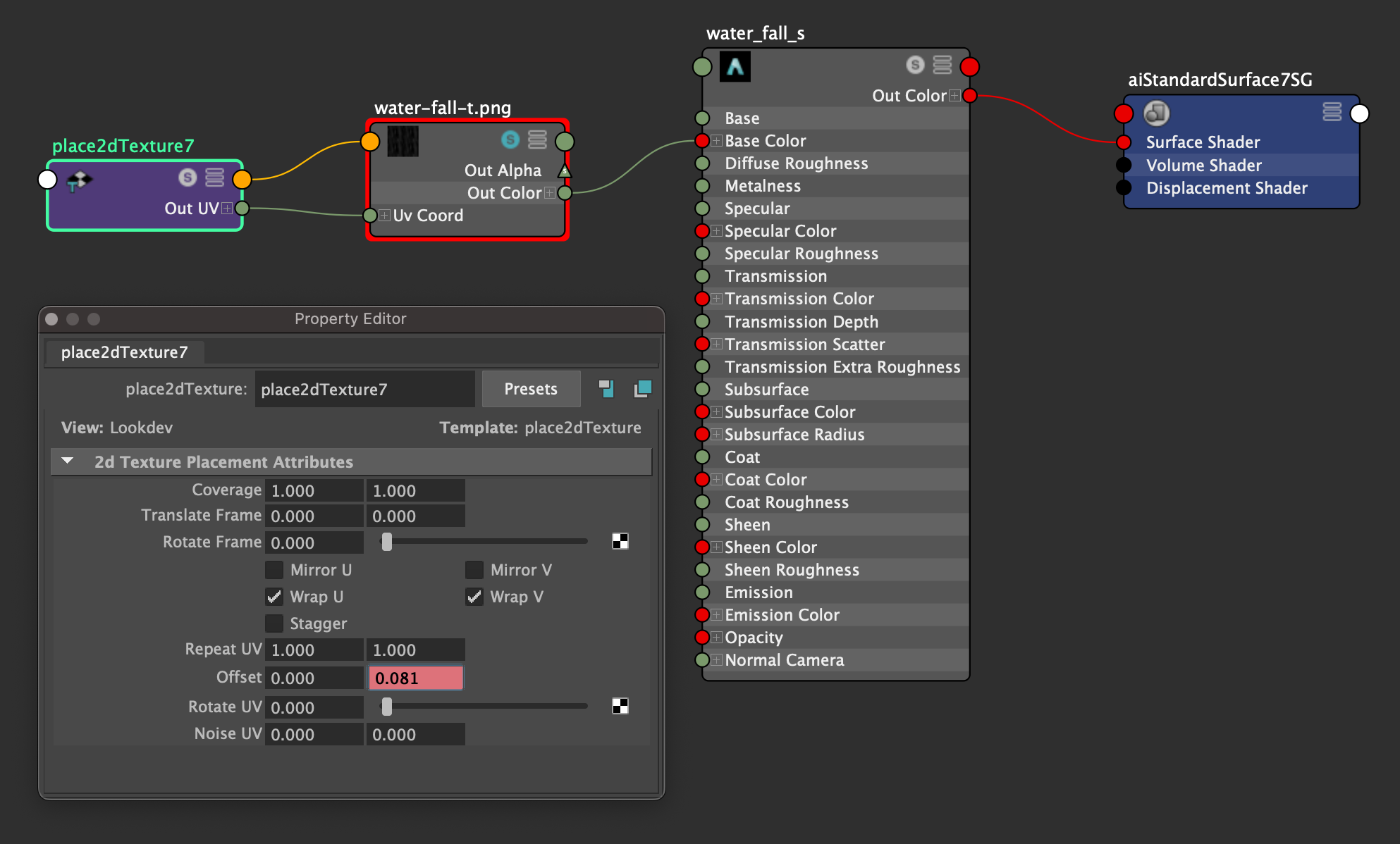

    I set keys the UV offsets to scroll to recreate the flow of water, and it works fine on the maya view, but does not animate when exported in Verge3D (I’m using maya2022).
    It seems that Verge3D 3.5 pre2 now supports animation of texture offsets.
    Verge3D 3.5 pre2 available!
    I’m using Verge3D 3.8.1. Why does it not work?
    I have attached my screenshot below.
    Thank you.
    #46960
    This setup should work. Can you please provide a test scene with this material so we could reproduce this issue?
