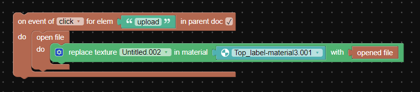

    I now have a new problem, when uploading artwork which will be placed on the 3D object, jpg and png files work perfectly. I want to know if its possible for pdf’s to be uploaded and loaded onto the object just like how the image file types work?
    #48843
    unfortunately you cannot use PDF files as textures directly.
