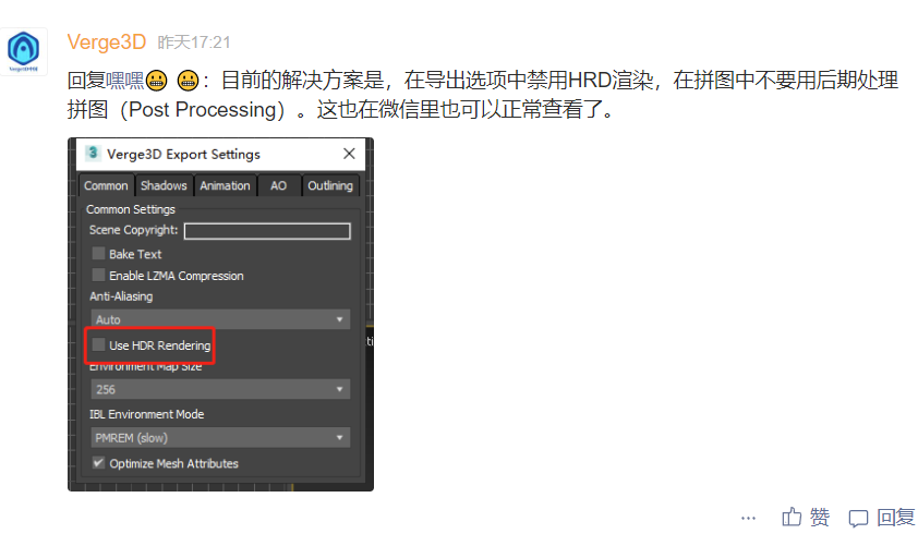

    That’s caused by iOS 15.4 update, and what has been repaired in 3.9.1 and 4.0 pre3 for the native browser, but still has bugs in WeChat. Try to open the link in Safari, it will be fine. Or you can try to disable Use HDR Rendering in export setting and remove all Post-Processing puzzles at present.
    iOS 15.4+的问题,3.9.1和4.0 pre 3做了修复,在Safari浏览器打开正常,但在微信中还有异常。开发组计划在下一个版本中处理微信的异常。当前处理方式是:1. 禁用 Use HDR Rendering; 2. 拼图中不要使用Post-Processing拼图。
