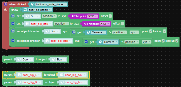

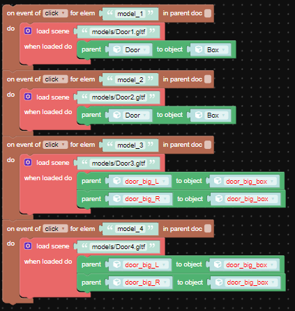

    There is a project built in Puzzles. I will attach the photos below. Everything opens correctly in the Xnview browser. I’m trying to launch in safari using the configured httpS server, AR does not turn on. Tell me what I’m doing wrong.

    Two elements with id “VR” (the second one will never be found by getElementById()). Wrong “rel” value (a instead of ar).
