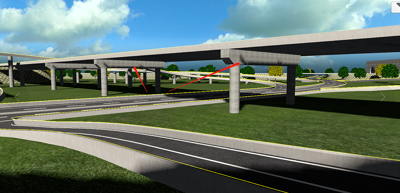

    I am using the 3ds Max version, and in a relatively large scene (1 square kilometer), the shadows cast by objects are incomplete. I tried to change the shadow map to 8192, but it still did not work. Do you have any suggestions to make it better?

    • try adjusting the bias parameter
    • try decreasing the Falloff/Field parameter
    • select a different shadow filtering type to check if the error persists
    Also recommend checking out this section
