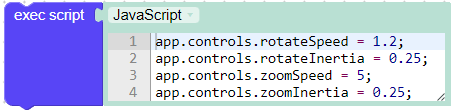

    #56182
    felix
    I’m so sorry, but I don’t know where to put them :wacko: . I am new in this world of script and verge3D :cry:
    #56183
    Open the puzzle editor, Advanced -> exec script
    #56185
    felix
