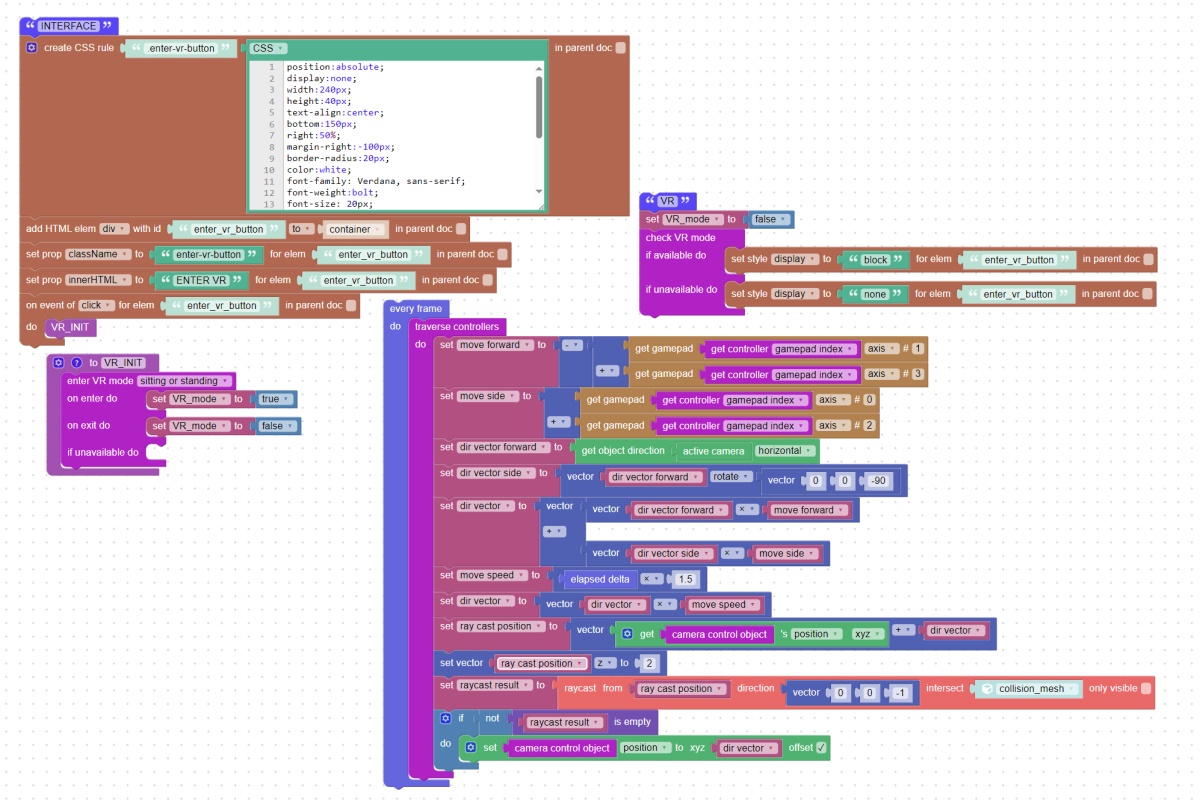

    I just created a simple & basic VR setup with verge and testing on Quest3.
    in VR everything opens well and only I can’t travel or navigate with VR controllers.
    what am I missing in this?
    I hope my puzzle set up correct & complete?

    Attach here your simple app as it is. With the .blend file. In this case only debugging can help.

    I got it resolved. the Normals of the collision plane were reversed & it wasnt detecting the end of mesh. I believe that was the right reason. lol
