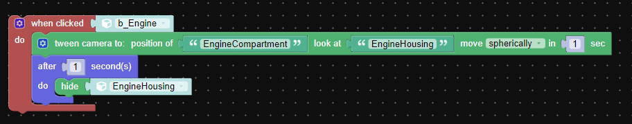

    Is it possible to show and hide an object in the scene that has a transition that occurs over time?
    The only way I can figure out makes the object instantly appear or disappear.
    Show Hide
    Thanks!

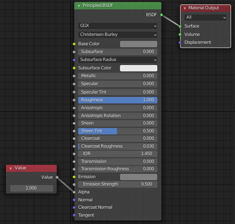

    can use alpha channel animation using the value node. from 1 to 0. and then hiding through puzzles.
    #57175
    jefferywright
    Thanks for the info, I can’t seem to find an Alpha attribute to animate in Blender Object Properties.
    Where would that be located?
    Interactive Multimedia and Visual Design
    https://jefferywright.com/
    #57176
    You should add the Value node and connect it to the Alpha input
    Then you can animate this value in Verge3D. Or you can animate the alpha value right in Blender and use this animation in V3D.
