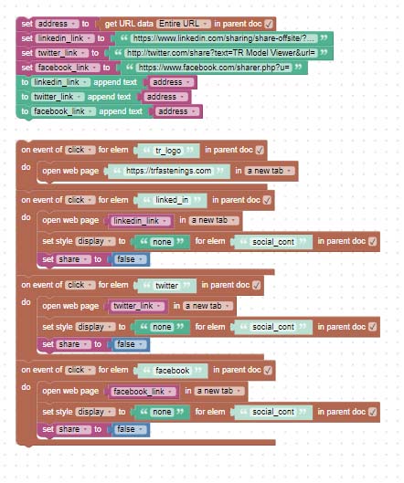

    Been playing with Verge for about a week now and am very impressed. Very intuitive. I’m having a problem with the share via social medial puzzle.
    My project is model_viewer.html but I need it to run via index.html which has the interface
    When I try to share via LinkedIn using the Sharing Link puzzle it only shares the link to model_viewer.html so no interface appears. I need it to share the link to index.html
    How can I fix this? Also, is there a way to customize the large Verge3D graphic that appears in the post in LinkedIn
    Thanks
    #48124
    keithgibb
    Got round this by getting the parent URL using Get URL data puzzle then created the correct URL to post to linked-in which I open in a web pages
    Is this a good approach or could I have done it better
    #48128
    GLiFTeK
    Could you explain what your solution was in a bit more detail please?
    Thanks
    #48146
    keithgibb
    Attached snapshot of the puzzles I used explains clearly. Not the most elegant solution but it works!
