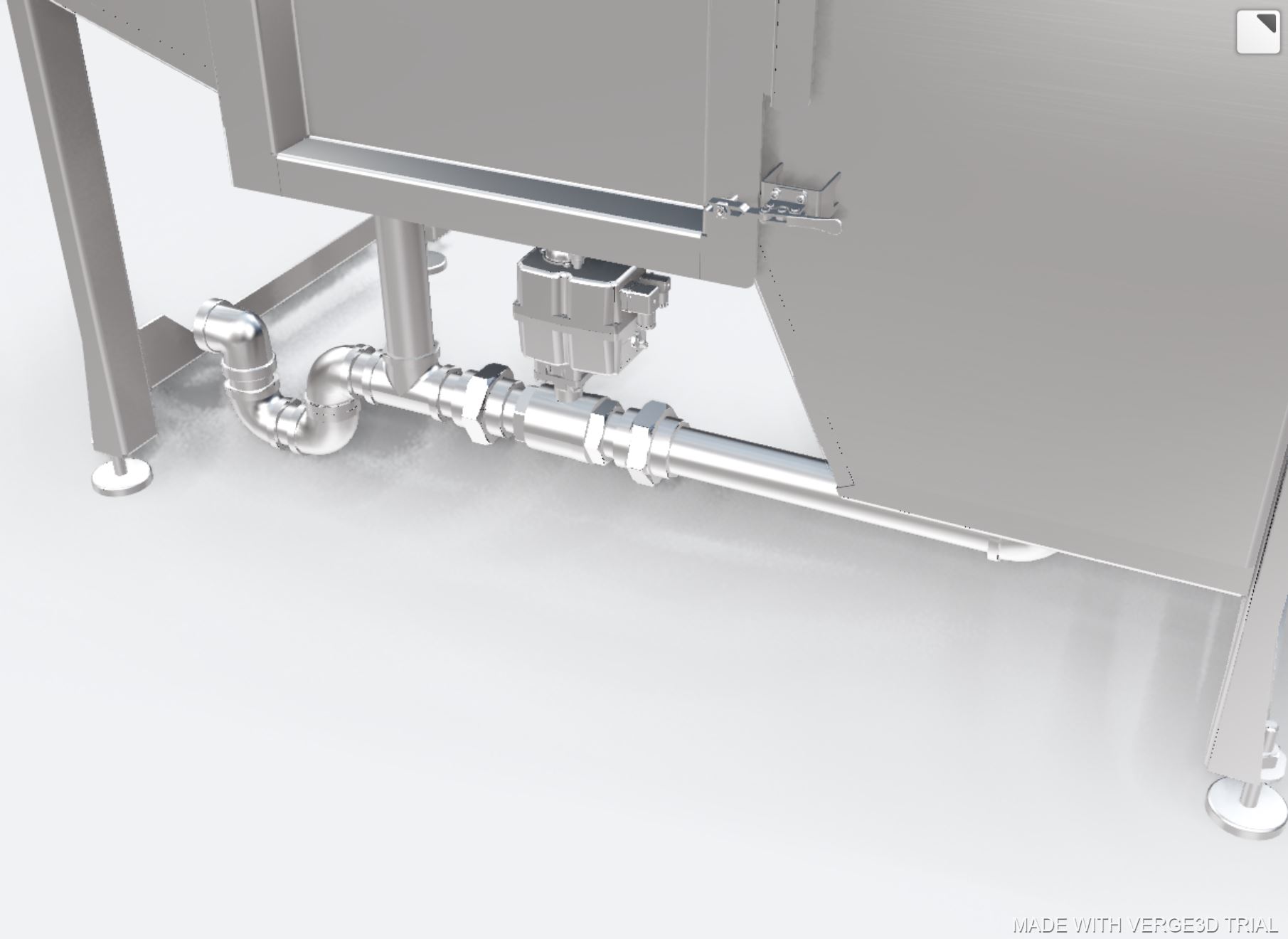

    ESM Shadow Filtering, .1 scale
    No lights in the scene, just an environment hdri.
    AO enabled, 1.0m distance, Factor .5, Trace Precision .5, Bent Normals checked.

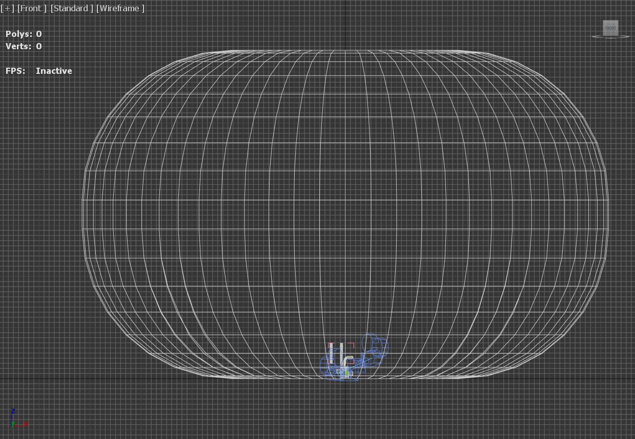

    Scene setup as shown in grab.
    Anyway to improve these floor shadows? They seem very blocky and I’m not sure why. Thank you.
    #48056
    Try to decrease as maximum as possible max distance of camera clipping.
